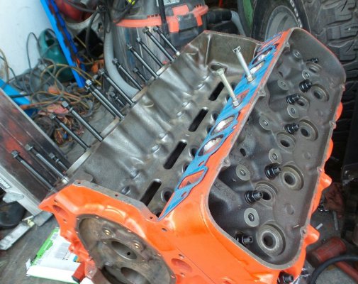

Okay, after some serious thought, going to continue to build the Mark IV ..
I went and picked up the Gen VII 496 ci, it's still on the trailer along with a Gen VI 454 ci that happen to jump onboard ..
The Gen VI has a factory roller cam, one piece rear main seal was produced from 1996 to 2001, and the Gen VII (Vortec 8100) began production in 2001 to 2009 ..
Both of these late model Big Blocks are butt ugly IMO ..
They lack the looks of the early BB's ..
Take a bucket full of green to get them to look good ...
Not sure what I'll do with them just yet, might build em back to stock and flip em ? .. Or part em out ...

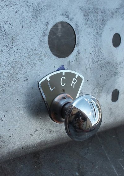

Still looking for tank number three ..
I have the IH Oem 16 ga left side tank and a 30 ga center tank, but I have been searching for the factory optional auxiliary 16 ga right side tank for about 3 years ..
Be super nice to have that Nos dash fuel gauge switch (That puppy was very hard to find) working in all three modes ..

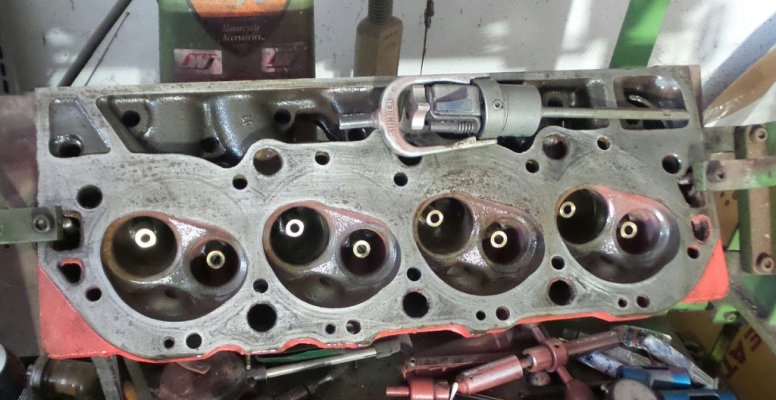

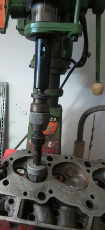

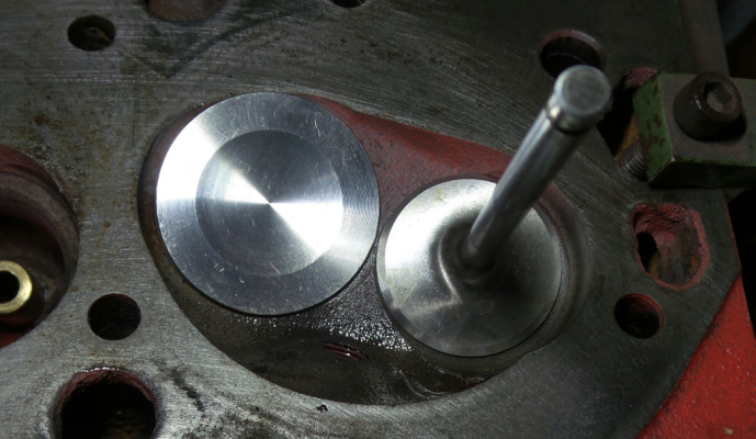

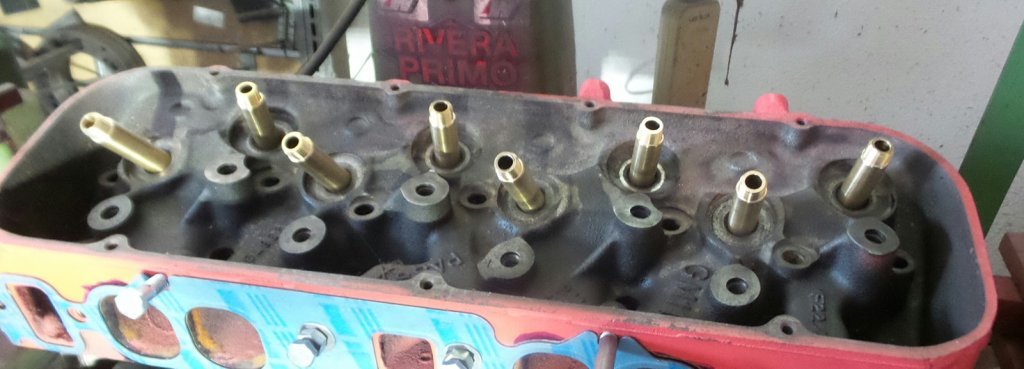

Did some backing up on the 4-bolt 496" Mark IV motor ...
Not something I wanted to do, was needing to buy some tools so I could work the 781 heads so I sold the 4-bolt main block ...
Bowl hog takes out meat really fast ..
With oversize valves going in, got a need for this tool ...
The fellow who bought the 4-bolt block wants me to finish building it ..
Since it was needing a crank, rods and pistons, game plan was to get a rotating assembly, so the 496" stroker is still in play..
Also sold him the heads off my 2-bolt 454" motor ... The 781 heads will be going on that motor, in time I'll run up on another 4-bolt Mark IV block and build it to 496 cubes ..

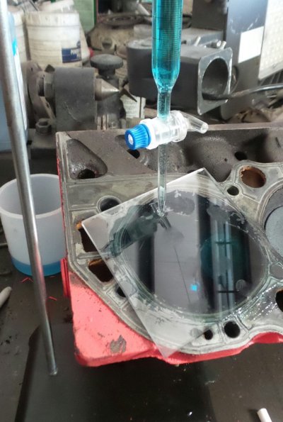

Had the need to know the camber volume in order to have around 9.5 to 1 compression ...
Another tool was needed ..
It was 118 cc's ... Pistons for the rotating assembly needs to have about a 12 cc dome ..
