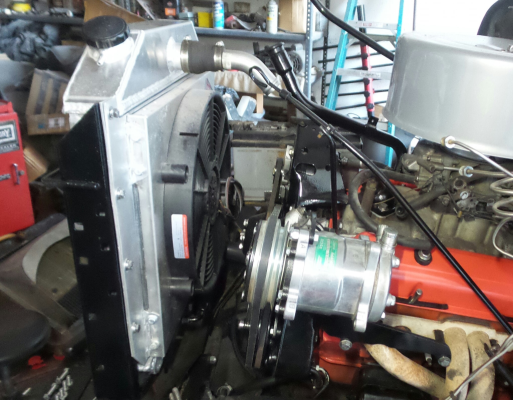

Making up a union for the top hose ..
Might leave the bend in it or cut the bend out and weld the two pieces together ??
Still in the think tank on that !
Going to get the rad. mounted in the truck and take a look at how the bend flows to the thermostat housing which is from a 55 Chevy 265 ci V-8 .... It's cast iron ..

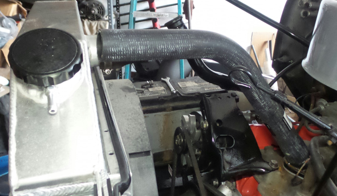

Had to order a hose that's made for God only knows ... It has a bend in it but does have a long enough run for me to do some slice & dice on ...
It was ordered, will be here tomorrow ..

Did a test fit on the top hose ...
Being it has a bend in it makes it a really good fit ...

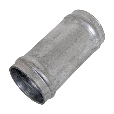

Netted a much better look than using the 45 degree connector that I have in hand ..
Had to order a straight connector ..
Since a order went in also got a few hose clamps that are better than the standard worm type clamps ..

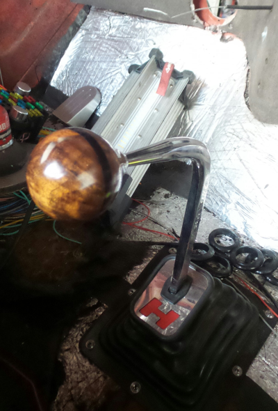

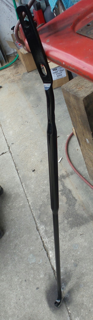

Been working on extending the transfer case to engine block strut rod ..
Hope to have it done and on in a few more hours .. ??
Got to dimple the exhaust pipe a half inch or so ..
Plumbed the transmission cooler lines .. That went down pretty nice ..
Radiator support cross rods needs to be a bit longer ..
Getting another one from a Junker so there would only one weld to do ..
Still waiting for the hose connector and clamps to come in ..

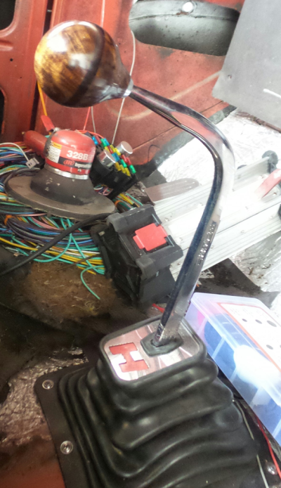

The rod was off of a truck that had a TH 350 trans and a NP-203 transfer case, with what I now have going on with the tranny swap it was about 6 inches to short ...
Making good progress ...
