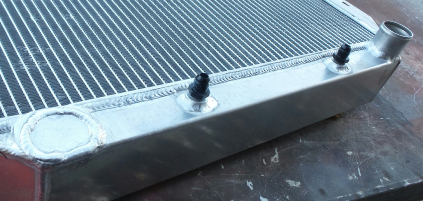

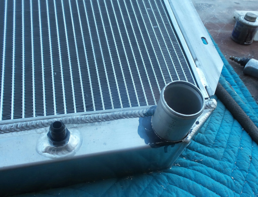

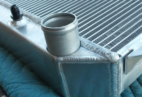

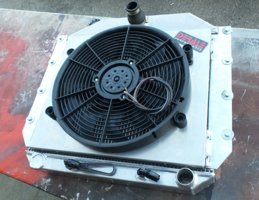

Radiator work is going well ..

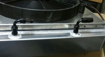

The custom outlet came in, got the hole cut in the tank ..
Time to fire up the Miller ..
Your going to like that radiator. I have a Champion in the Corvette. It works very well. I have a set of electric fans on the Vette from a Ford, Fusion. They do good, but do pull a little hard on start up. Maybe 40 amps. I had a set of Corvette C-5 fans on it, when I bought the car , last year. I replaced them, looking of better cooling, but the issues wasn't the fans. It was the wiring that supported them. On my 97, Silverado, I have a set of Cadillac DeVille fans. They work grate. They pull a lot of air, and are quite. Neither vehicle, ever over heats. Doesn't matter, if I'm in traffic on a 100 degree day, or getting some chicken, at Popeyes, drive through, on a 100 degree day. Only thing about running electric fans, is you really need to do the big 3 upgrade, to support the extra draw I on the charging system. If you have any questions, feel free to ask. Also, just an FYI, I like to run a smaller pulley on my alternators. This is a big hello at idle, if your not already running a large amount alternator. I just replaced the alt on the Vette, with an off the shelf autozone 1, 63 amp. I have a 140 amp, that went out. So I pulled the pulley off of the 140 amp alt, and sure enough it's smaller, than the OE rebuilt one. I swapped them out, and, yes, it charges better at low RPMs.
