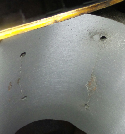

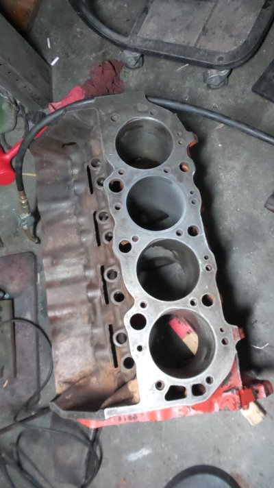

Got a flanged sleeve coming from LA Sleeve ...
Be nice to have a block that don't need work ... (Outside of boring oversize)
But, I'm cool with this block since it is the last year of the Mark IV's ... Makes it kind of special !

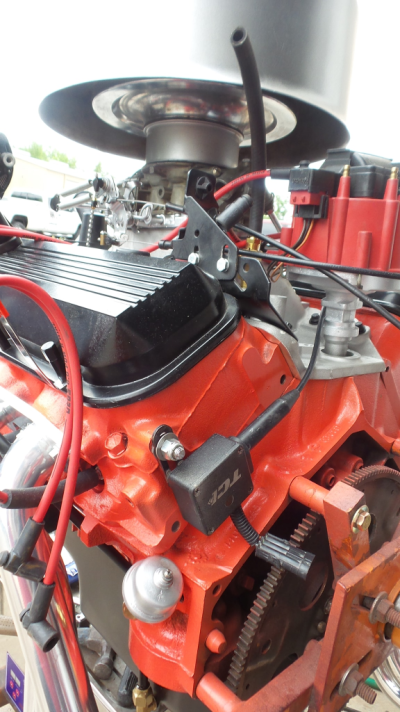

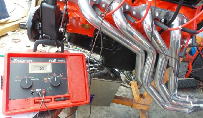

Found a nice out of the way spot to mount TCI's TPS unit ...
Nailed it to a unused threaded hole at the back of the head ..
Did a test to make sure it's working good ...
Also upgrading the connector to a waterproof one ..

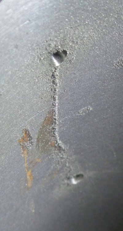

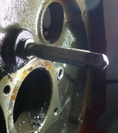

Got some grinding to do and back in the stand it'll go ..
Not all that sure I want to bore to .060" over ..
.030" would clean up the bores since they are STD ..
