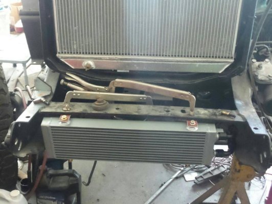

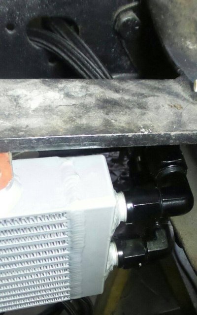

Installed a motor oil cooler ...
Took a long while to find a cooler that would fit in the spot I had in mind of mounting it ..

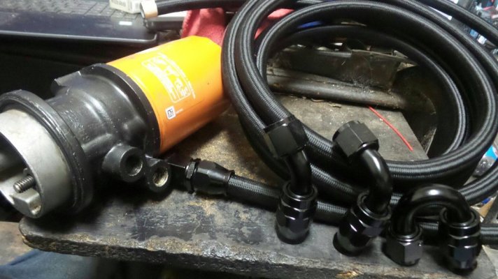

Already nailed down a og GM sandwich adapter ...
Was going to use AN-8 hose, but the cooler came with AN-10 fittings welded on ..

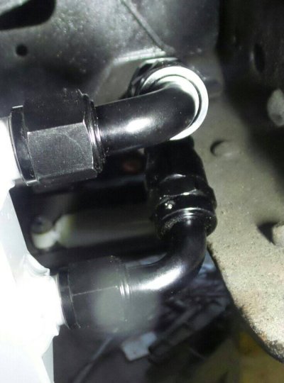

A bit of backing up on parts to make this happen was needed ..
After plumbing the cooler with the new lines and fittings seen a problem with not having enough room for the cooler to fit between the frame rails ...
Different hose fittings helped the cause ..

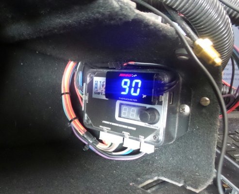

Since the cooler will be dropping the oil temp wanted to know what the temperature was ...
Found a small gauge that I hid in the glove box ...
