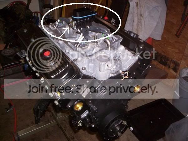

Sounds like you need to tint the headlights. Sun is clearly leaking in and evaporating all of your gas.![]()
I damn near shite myself. That's just funny I don't care who you are.Dont have vaccum hose to the fuel pressure regulator. The fuel pressure regulator is under the intake manifold along with the injectors.
It's been a long hard battle but I'm very happy to see it's been worth itSo how does it drive on the road?
