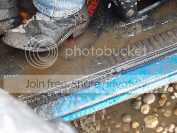

Cowboy Cadillac
Ain't no trash in my trailer!
Jul 19, 2009
3,915
Grande Prairie, AB, Canada
You dont want this to happen to you! :fingersx:
No this wasn't Dennis...but he was present.
