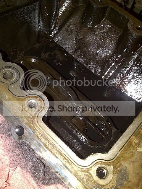

Here is one of 2 pics I have,
This one makes me nervous, but also happy that I bought a kit to replace all the little annoying fittings and screens.
That ripped screen means that my timely oil changes were needed. It is the high pressure oil pump screen. The pump fires the injectors (3-4000+ PSI I think), they run very tight tolerances and the sludge in the oil could cause a failure and this screen is supposed to stop it. I have new injectors so I am not worried about it.
Planning ahead is nice, when I do it!!

Jake, think I should replace the HPOP? Never had an issue, just a cold stumble
agjake11
Oral the Coal
Jan 23, 2010
8,446
Rosenberg/Beaumont TX
Not unless your having an issue yet. There's no aftermarket upgraded Hpop for 05+ yet so I'd hang on till you really need one
