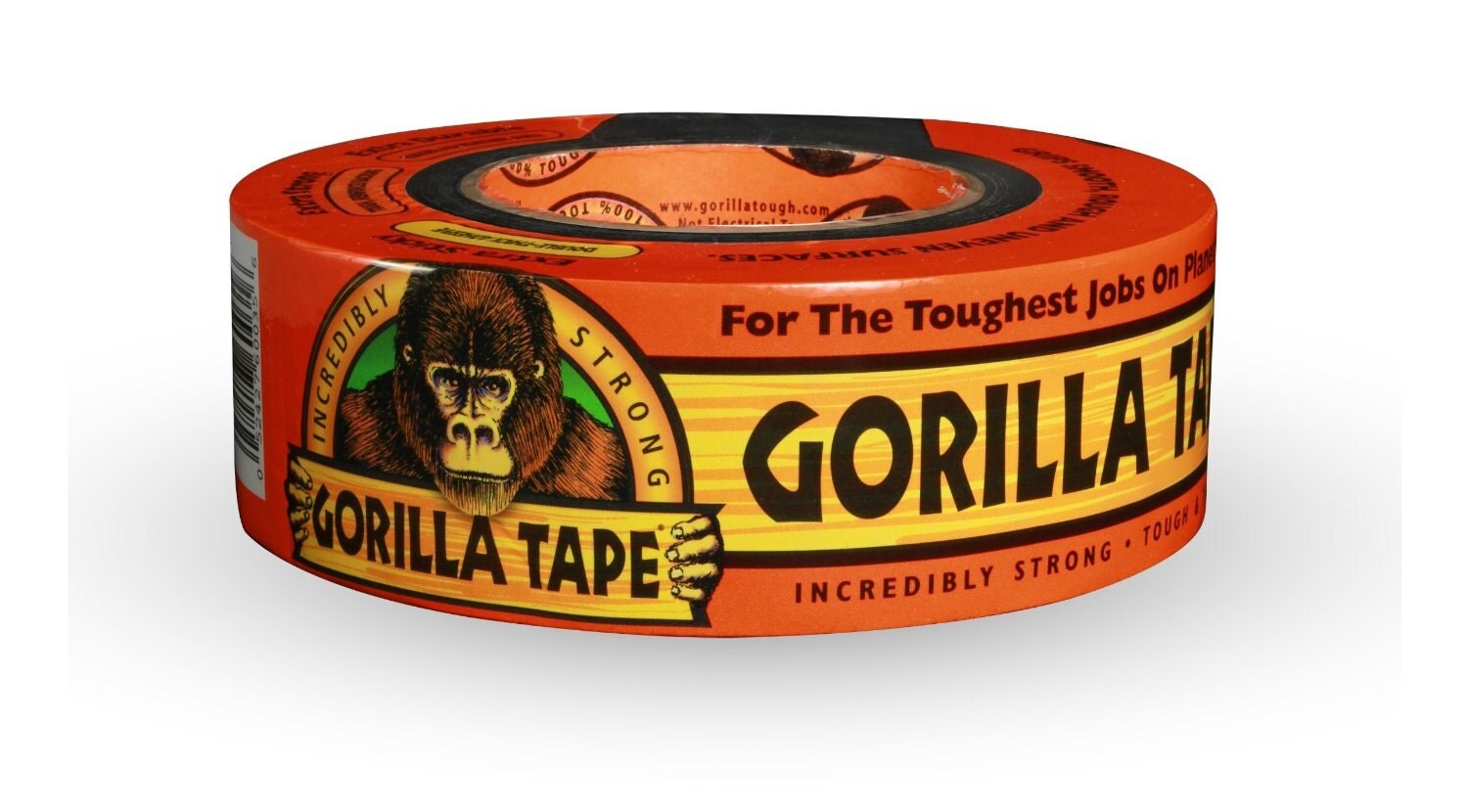

Just keep this handy to put things back together when they blow! :lol:
...and I feel like you have jinxed me! I want to find a bulletproof solution, so that I am not stuck in a Walmart parking lot, in the 'hood somewhere on my side of the Rockies :jester:
