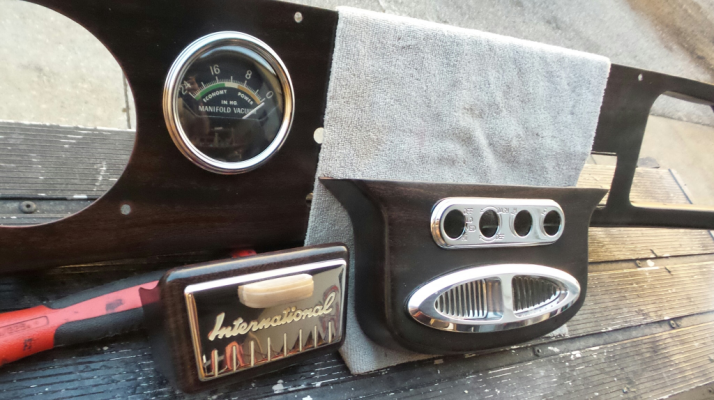

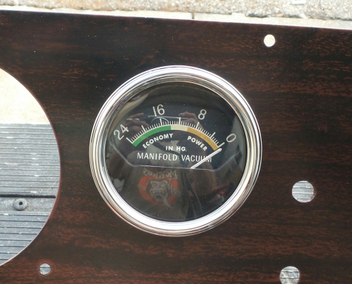

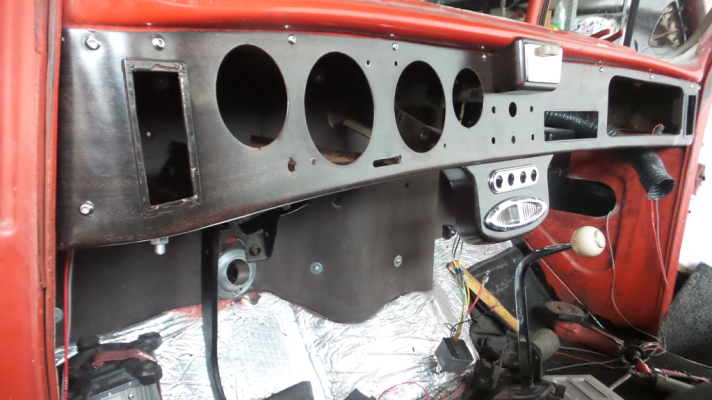

Got the vacuum gauge done, looks brand new for 60 year old stuff ..
Just about got all the parts for the dashboard, still need to order the wiper switch adapter so a stock IH knob can be used ..
Had a problem with the clear coat ... A few spots clouded up, tried to sand them out but broke though the woodgrain ..
Sooooo, get to do it all over again ... Eek !

Humidity did it ....
Here in Florida we been seeing a afternoon shower for the past 6 weeks ...
90 to 95 % humidity is common ... Guess I will wait for a day that's 70 % or less to try again ..
( That will give me time to sand, shoot another base coat and print the pattern on )

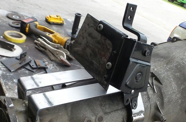

That's as far forward the shifter will go, it's in the four wheel Low mode ...
I was shooting windage with the location of the transfer case shifter ...
If I had mounted the transfer shifter much further forward I would have needed a shorter stick or redo the location on where I mounted the shifter onto the transmission support bracket ...
Pretty much nailed it ...

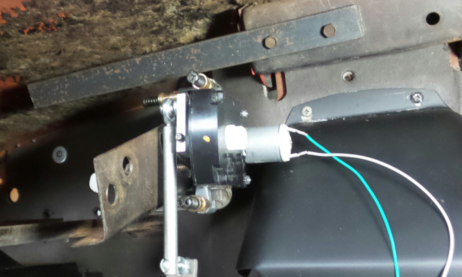

More behind the dash work ..
Getting the power unit mounted up ..
Kind of needed to do power on the cowl vent ..
After doing a test fit on the A/C pod gave no room to get a hand on the vent handle ...
Jesse S
Full Access Member
Mar 1, 2024
481
512
Belleview Florida US of A

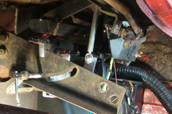

Well, so much for me thinking this would be easy ..
Dang windshield wiper stuff is taking up a lot of space that the power vent hardware needs to function ... More thought and fab work on my part is needed to go down ..
The arm that I made up needs two inches of swing ...
Got it working ...
Took some throw out of the motor's arm, really didn't need the full 2" that it came with ..
