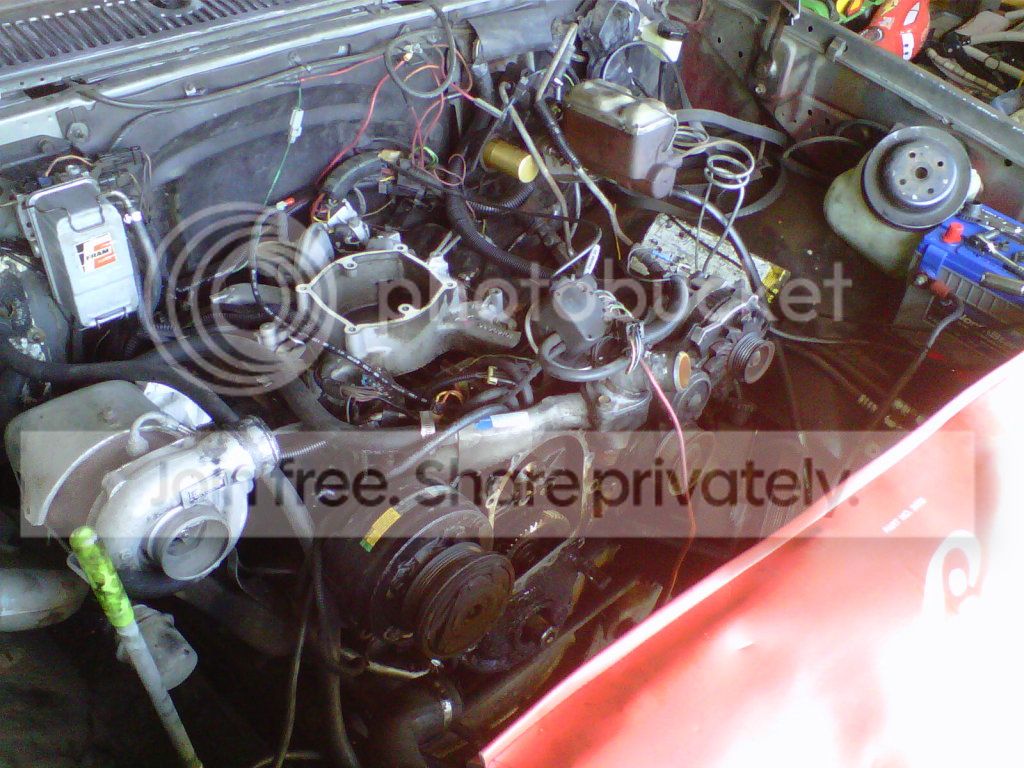

Today I got the rear sway bar bushings and links done, tried once again on the brake line and no show, so moved on to doing the water pump, that has turned into quite the tear down, what I thought was the pump leaking is actually the front cover, this is as far as I got today before I lost motivation, lol.
I have to pull the intake to get at the injection pump mounting bolts so i can pull that front cover, which in the end is best because i can do the front seal. cause this engine is dirty as hell. why the hell can`t people clean under the hood once a year for fWONK sakes?
:lol:
still abit to do...

I think that turbo needs a freind. Maybe you should install another one on the other side.
