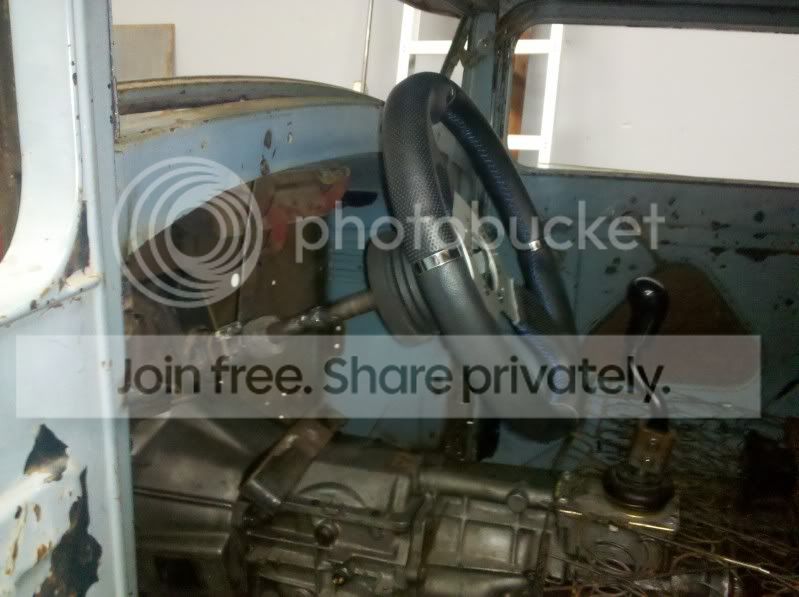

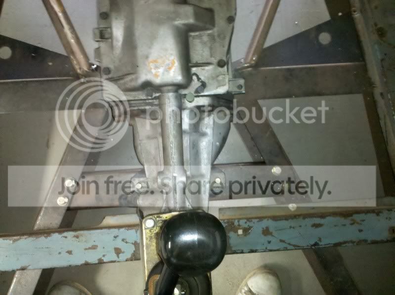

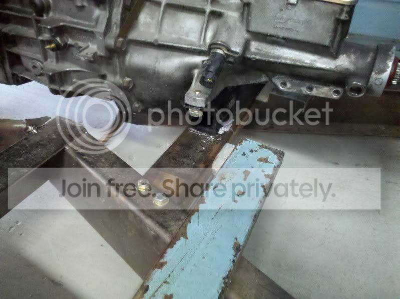

ok got a little more done on the truck
sorry, had my phone on the macro setting for the first few pics

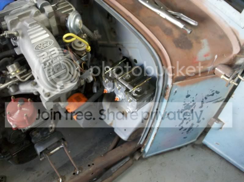

got the pedals mounted along with the master cylinders (just sitting in there in the pic) had to do some machining on the bracket to get it to work the way i wanted, still have to weld the brake pedal together the way i want it

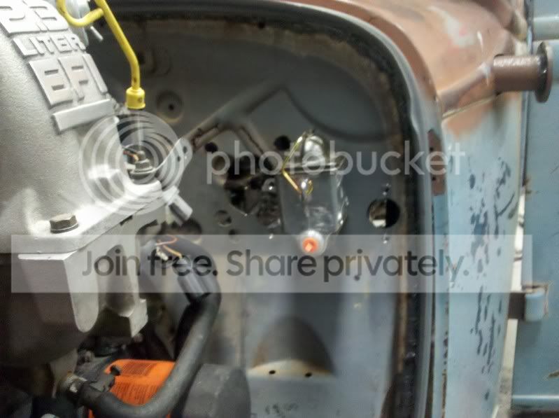

got the firewall in, had to weld the firewall up, the outer rim was cut off to make a custom one but decided to use the stock one, so had to weld it back together and there was over half an inch of a gap i had to fill in some places, due to widening the bottom front of the cab to fit over the frame.

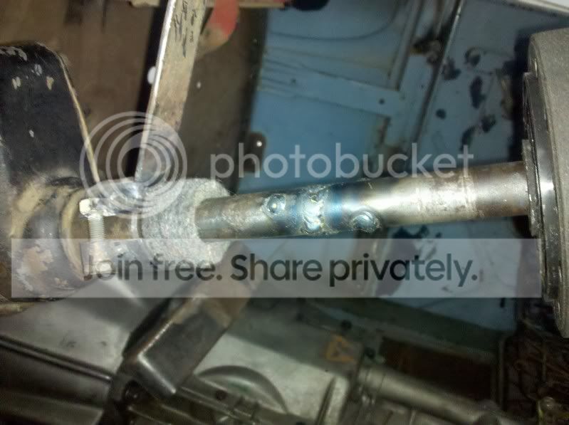

got the steering wheel on, so now the steering is completely done
got the transmission mount done, so now the engine and trans is mounted, no more blocks of wood, mocking it up

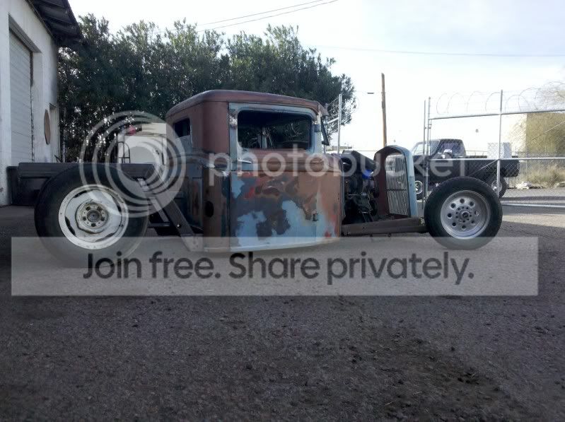

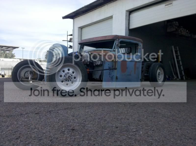

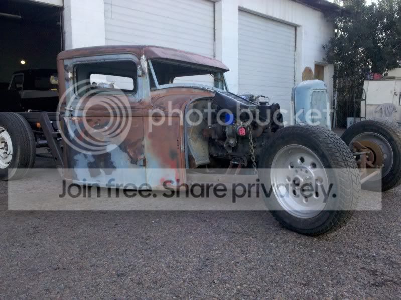

and since everything that is on the truck is on and mounted properly now, i rolled it out of the shop to clean the floors and to get some pics
thats about it for now, next is probably a floor, that and pull the engine out to give it and the trans a really good cleaning and maybe some fresh paint
