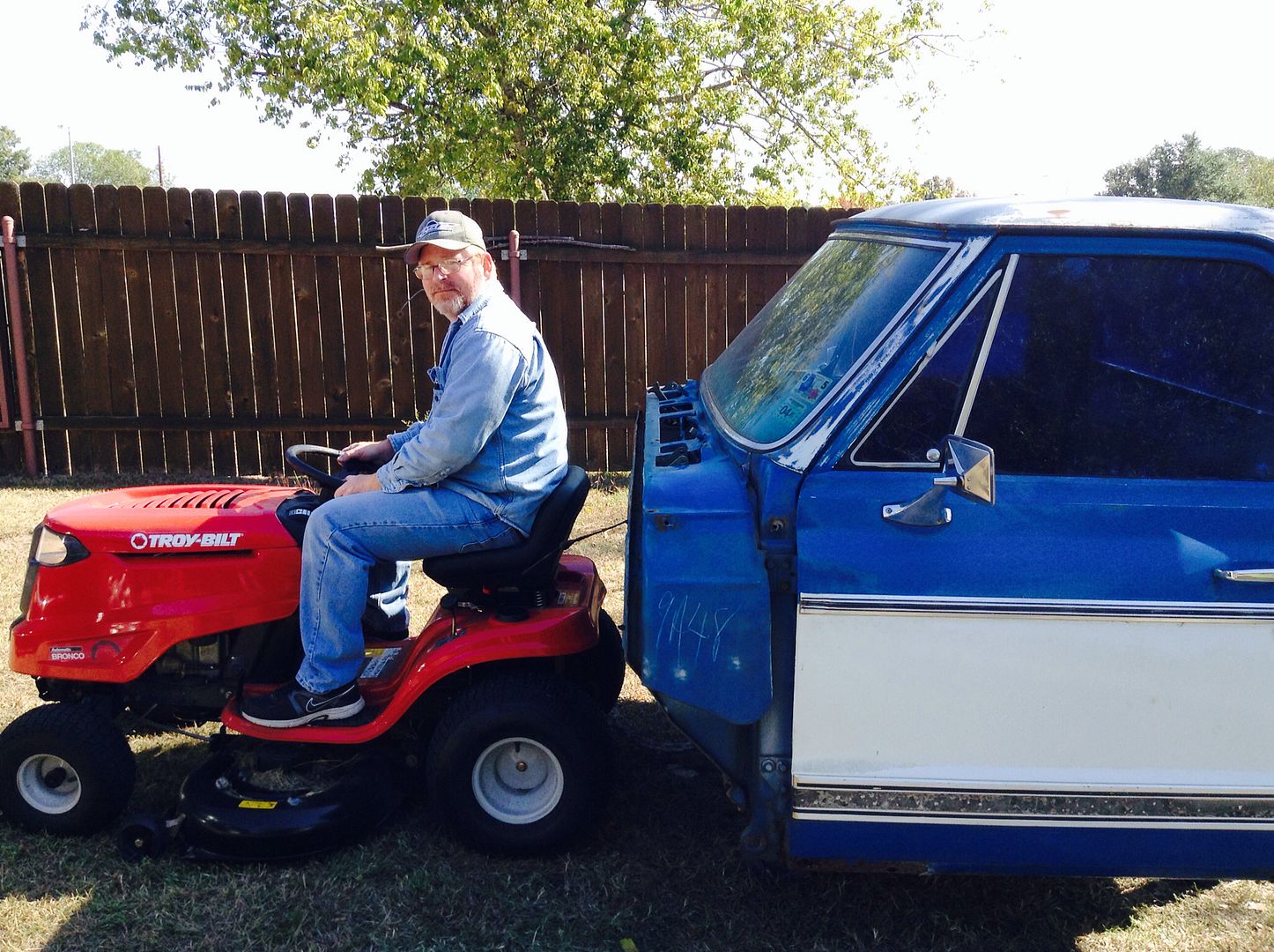

And my favorite shot, hooked up to the lawnmower giving the contraption a test pull. :D
