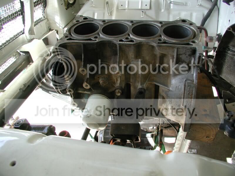

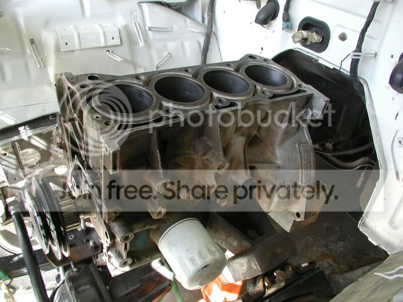

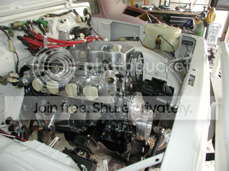

Well, decided to try and put an empty block in for a trail install run. This was also done to mock up some brackets for AC and TG Toy power steering pump. The FJ80 box is close to where these components are going to live and wanted to make sure I had a real time look and see. Finally found a stock AC compressor with the manifold adaptors on it to use.
Getting the crane hoist in place and the engine block on the floor to see if a bottom side install could be done. Physics set in and there wasn’t enough ram length to get this done. The block was installed from the top with out problems even with the extreme height.
The trany will go in first. Don’t want to have to struggle with fitting it from underneath which is more of a PITA.

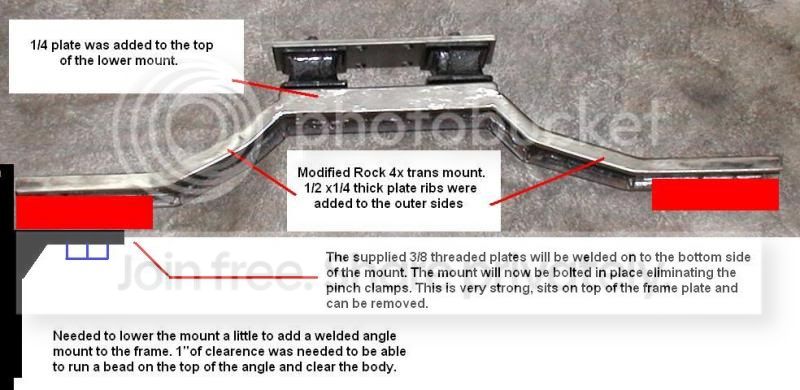

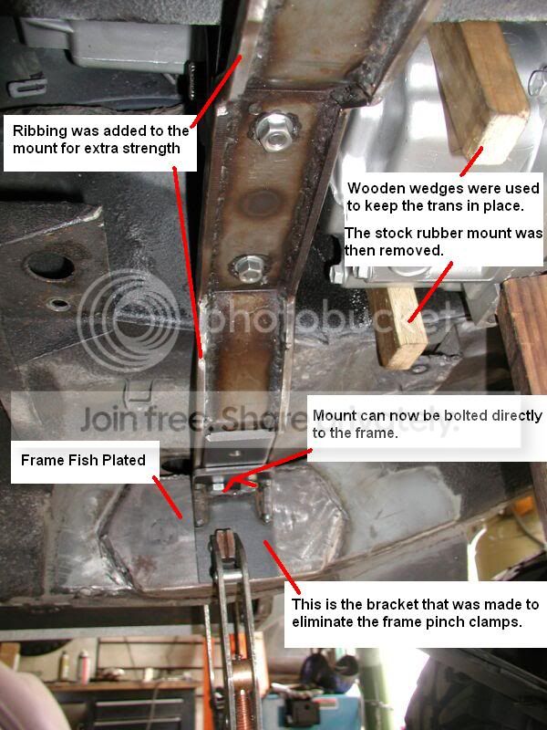

I’m also working on a removable trans mount. Ordered the Rock 4x mount to see how it looks. If used will probably modify it to eliminate pinch frame clamps and weld in a couple of angle pieces to the frame, this will make it a solid bolt in mount. May also add ¼ webbing around the outer sides of the mount this will add strengthen to the bent mount.
Here are a couple of pics of the block in for component clearances and bracket mock up. Engine bay hasn’t seen a block for about 2 years not really much of a big deal until you see the obstacles to over come to get it there.

The Rock 4x mount was purchased so I didn’t have to make all the parts from scratch. Wanted to say there was nothing wrong with what they offer just had something else in mind.
With the mods made it is much stronger and has an angle mount that is welded to the inside of the frame rail after fish plates were added. The mount now rides on top of the angle mount and is bolted in place and can be removed.

Got the AC compressor in on Friday, will be finishing the PS and AC bracket after the modified trans mount is completed.
Here is the modified Rock 4x mount installed. Liked the design of Scotts mount and let him know that I was going to make a weld in plate and do away with the pinch clamps.
Scott had mentioned that the mount was designed for those that didn’t weld just to make it a simple bolt on and the weld in bracket was cool with him.
Here is the weld in bracket option and was a bit time consuming to do.

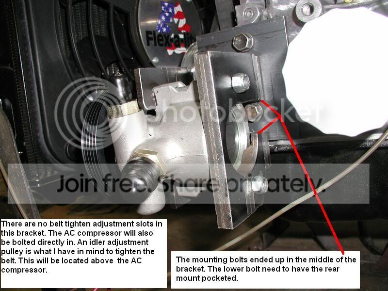

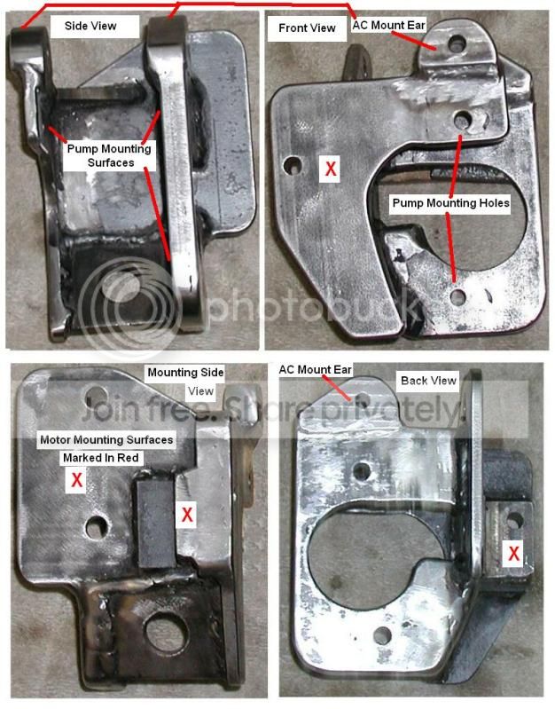

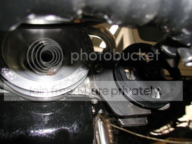

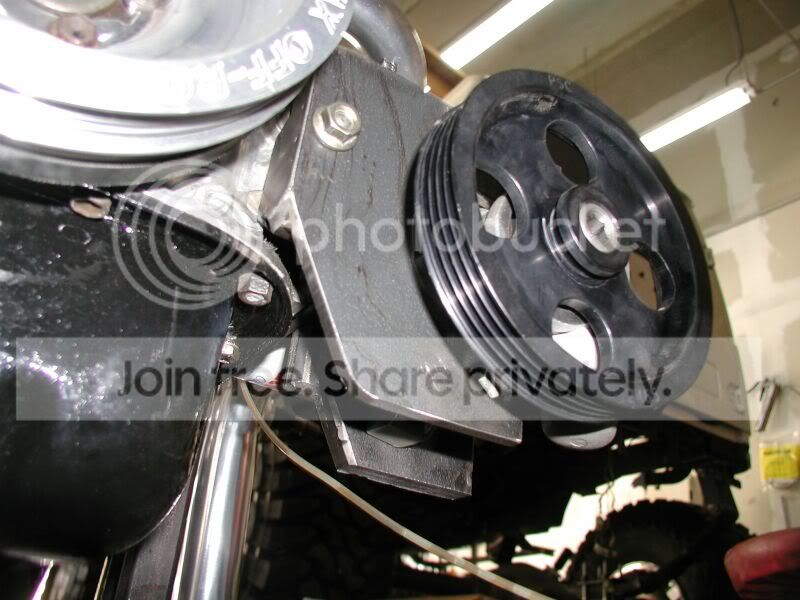

Here is the finished PS/AC bracket. Still have to make some type of belt tensioner.
Got to say this one really had me scratching my head a few times. Just because you made the bracket doesn’t mean you are going to be able to use the bracket.
There were a lot of obstacles to overcome while making this bracket:

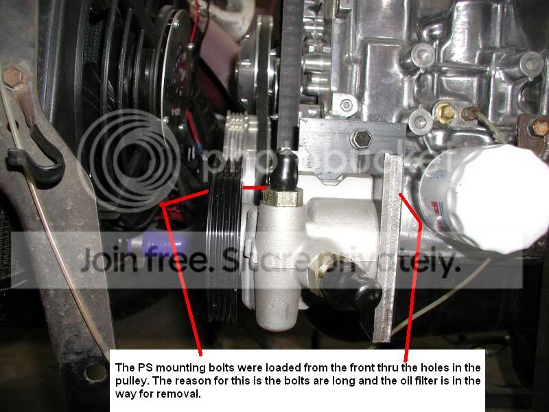

Rite off the bat the mounting bolt locations on the motor just happened to be dead middle of the rear support bracket.

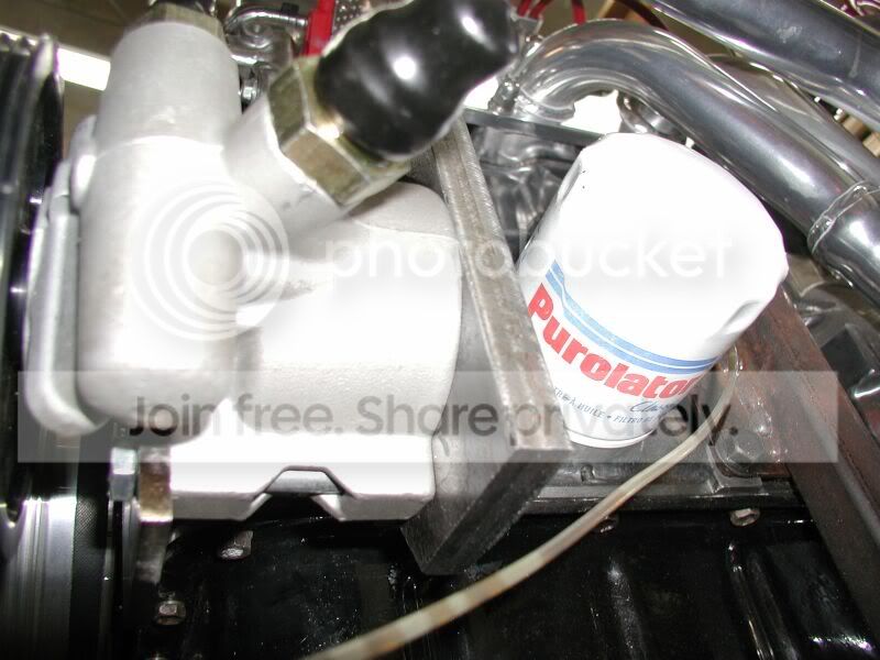

The top mounting bolt for the pump was too long to remove because of the oil filter.

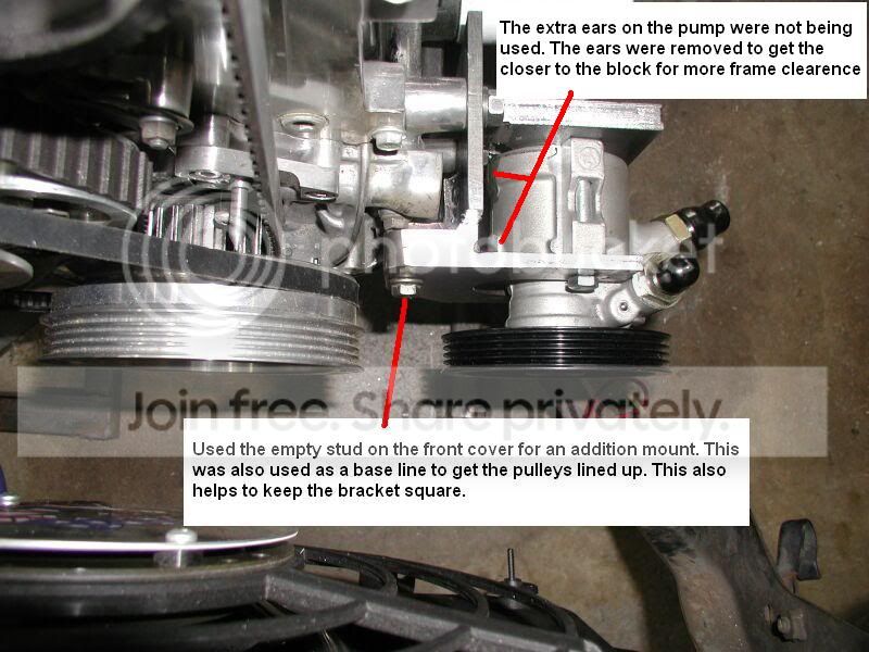

There wasn’t enough room to install the pump in the frame with the lower bracket ear on,
Welding a sandwich plate bracket will tend to move a bit making a tight fit if you are lucky.
Make the single bracket a simple design yet strong enough to hold both the PS/AC.
The top portion of the bracket needed to be left open to be able to pull tight on the PS/AC for a secure mounting.
Decided to use serpentine pulleys half way though making the brackets and lining up the pulleys was a bit of a challenge as well.
You can purchase a compressor but it does not come with the manifolds to connect the hoses to.
Probably forgot a few and finally got it done despite the obstacles.

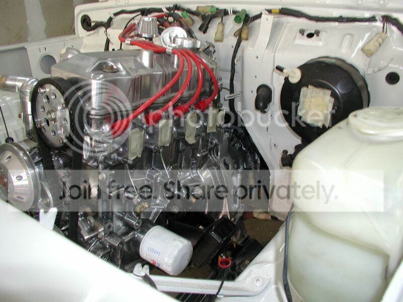

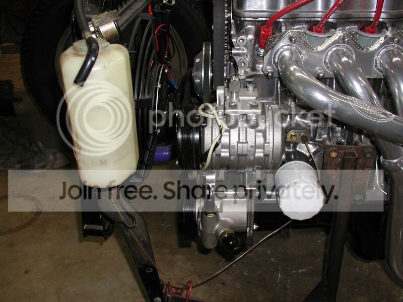

Finished up the belt tensioner and bracket and installed a 4 ribbed belt.

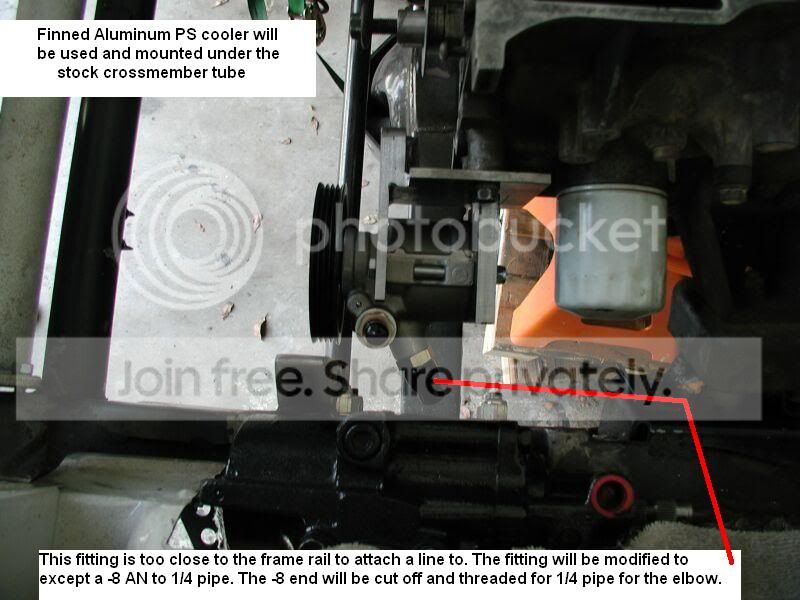

Needed to make a custom return line elbow for the pump because the pump is located between the frame and motor.
Here are a few views of the finished PS/AC. To mount the pump in the bracket with the motor in the engine compartment. The front lower arm needed to be removed which does not compromise the strength of the bracket.
