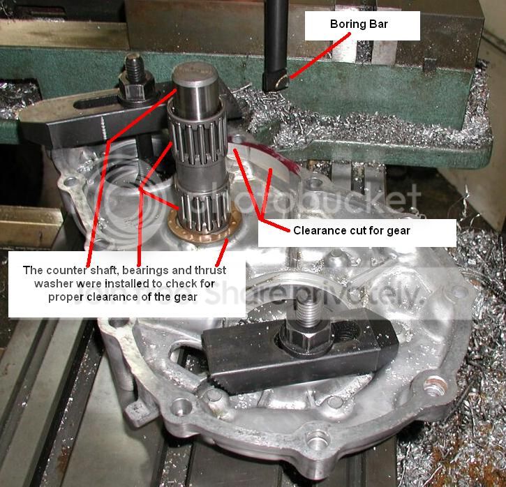

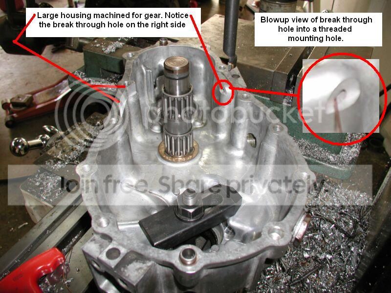

Clearance the housings::

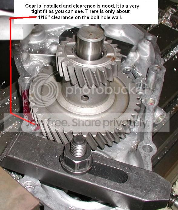

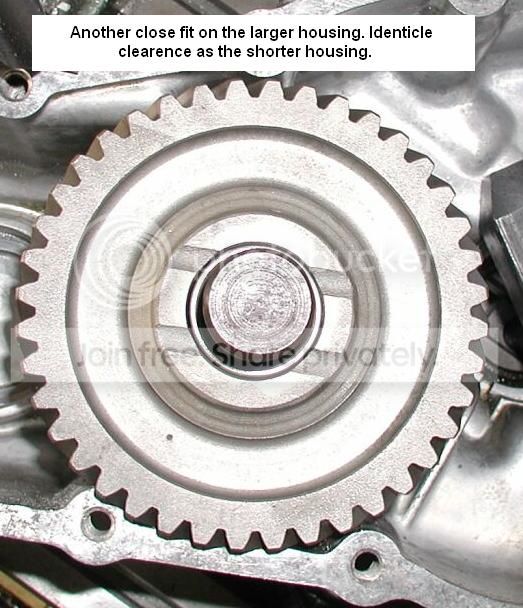

The 6.1 Countershaft Gear is a bit larger then the Trail Gear 6.5 Countershaft Gear. There is a need to clearance the case for the gear to fit.
The Mill was the tool of choice used for these reasons:
Maintaining a consistent radius to a determined depth.
Large amount of material being removed.
Thin walls after machining.
( There was about 3/16” removed from the side wall and about a ½” depth. This gave about a .050 clearance all the way around on the machined surfaces.)
Here are the housings being machined for the Gear.
Short Housing Pics.
