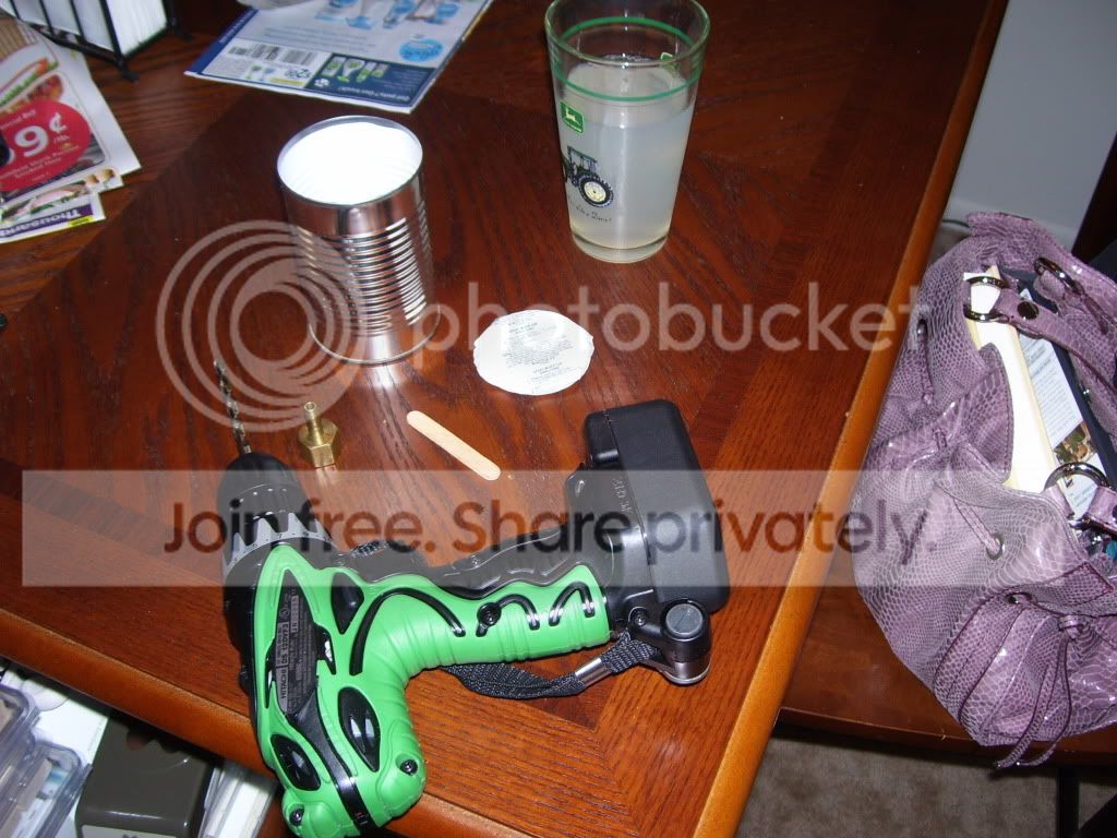

Here you go everyone. I need to install a petcock in my tank and in the mean time I want to start the bike. I decided to rig up a little tank. I decided to find what I had around the place to rig something up. This is what I came up with. A Can, cordless drill, brass fitting, 2-part apoxy and a stiff drink.

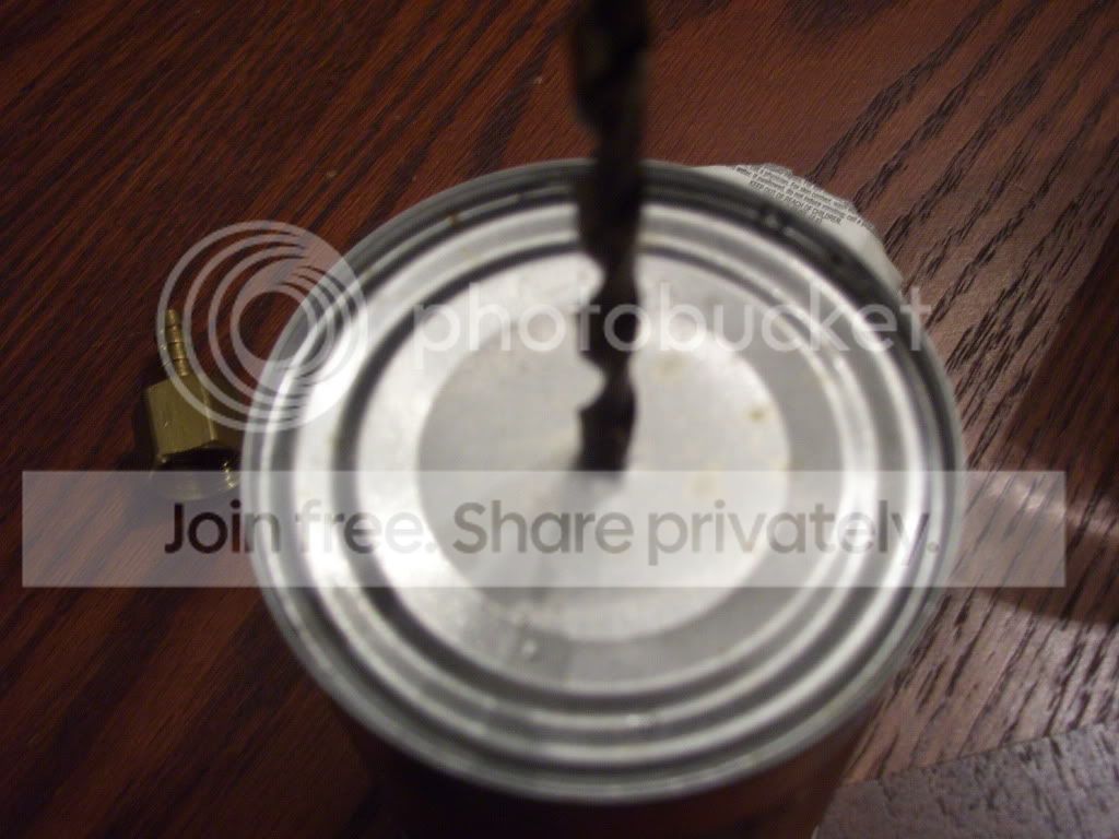

Drilled a hole in the can to accept the fitting

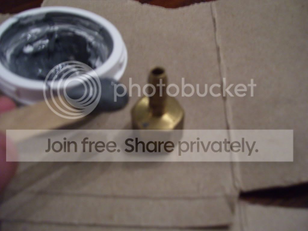

Then mixed up the apoxy and coated the fitting.

That stuff turns into concrete. We use it at work and I have yet to see it get eaten away. I think for the amount of exposer time it will be okay.
