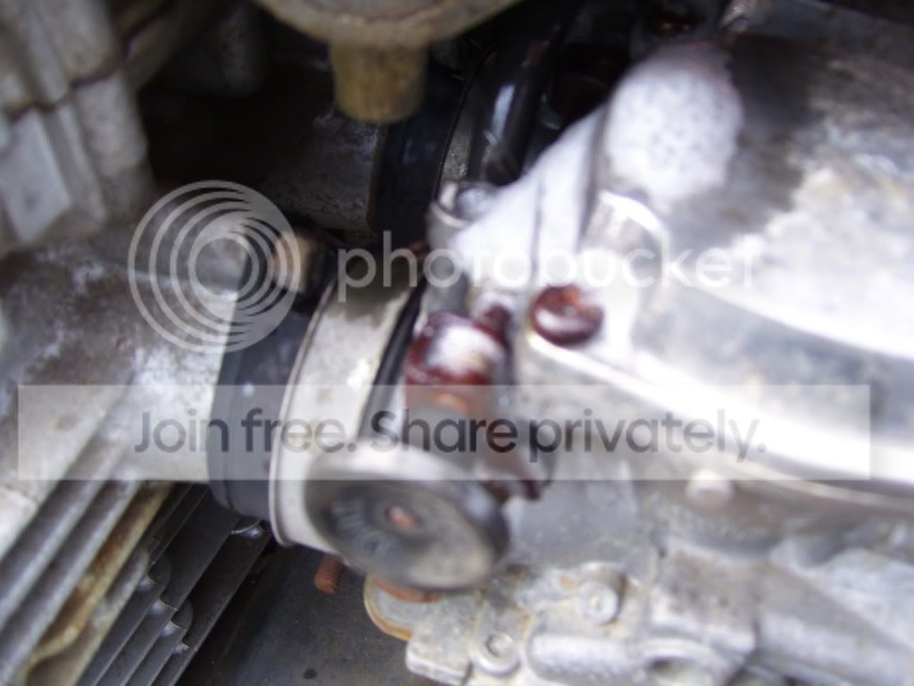

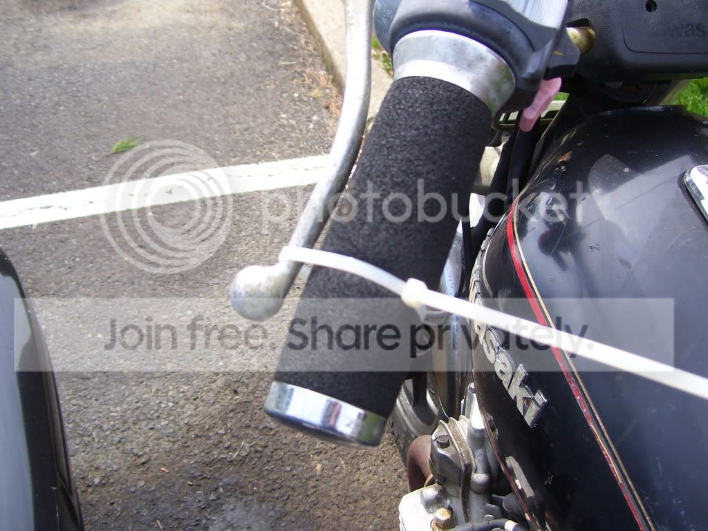

So today I went out and got started. The chokes are seized so I started to soak them in penetrating oil. The started to move a little so over the next few days I'm sure they will free up. I over filled the oil. I have the clutch held open with a zip tie to let the oil soak in between the plates. I put the bike in gear and spun the rear tire by hand. I think the clutch will be alright.
