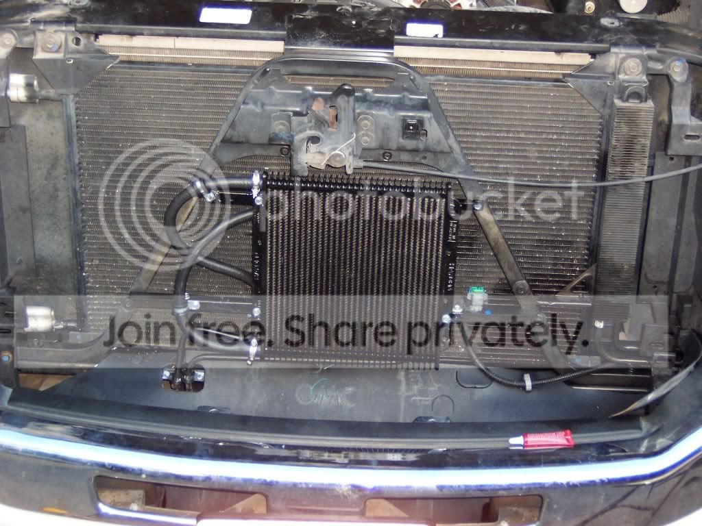

Looking at the pic you posted, is the area beneath the bumper still opening allowing air flow to get to the lowest part of the cond and rad? I know some people do some mods to their front end and block the airflow somewhat. Have you removed any plastic or rubber flaps? If you look at the pics I posted you'll notice the flap at the bottom that directs air to cond. bypassing the trans cooler

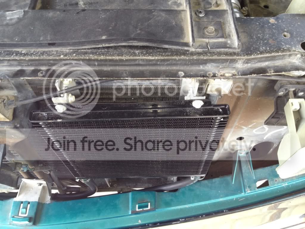

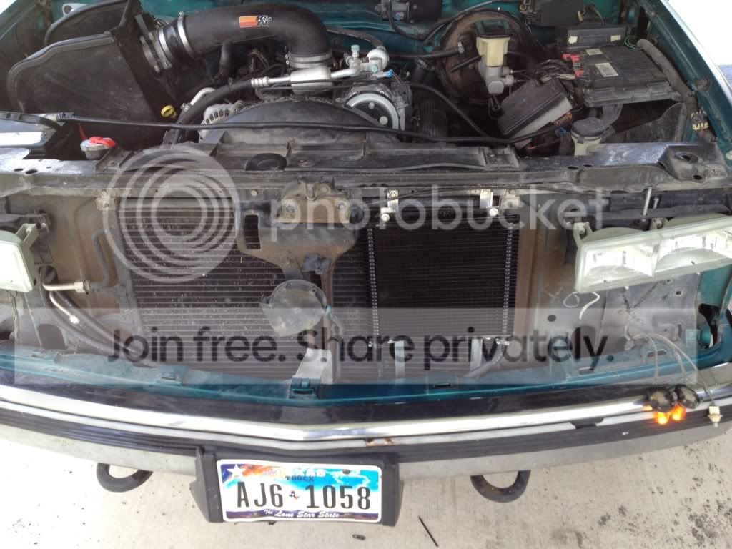

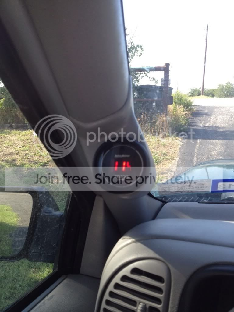

I know it's been a while since I started this thread but I finally had time the other day to reinstall the trans cooler.
I moved it to the driver side still in front of the cond. with a 1 1/4 gap.
Also cleaned the cond. out with a scrub brush. Ac performance is where it was before.

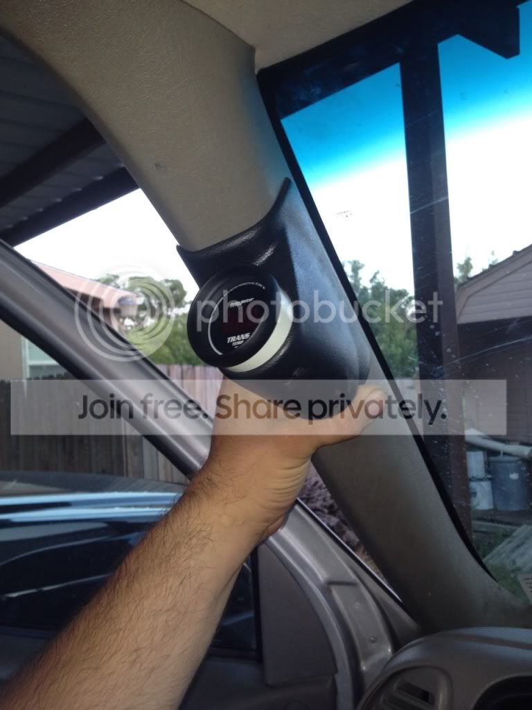

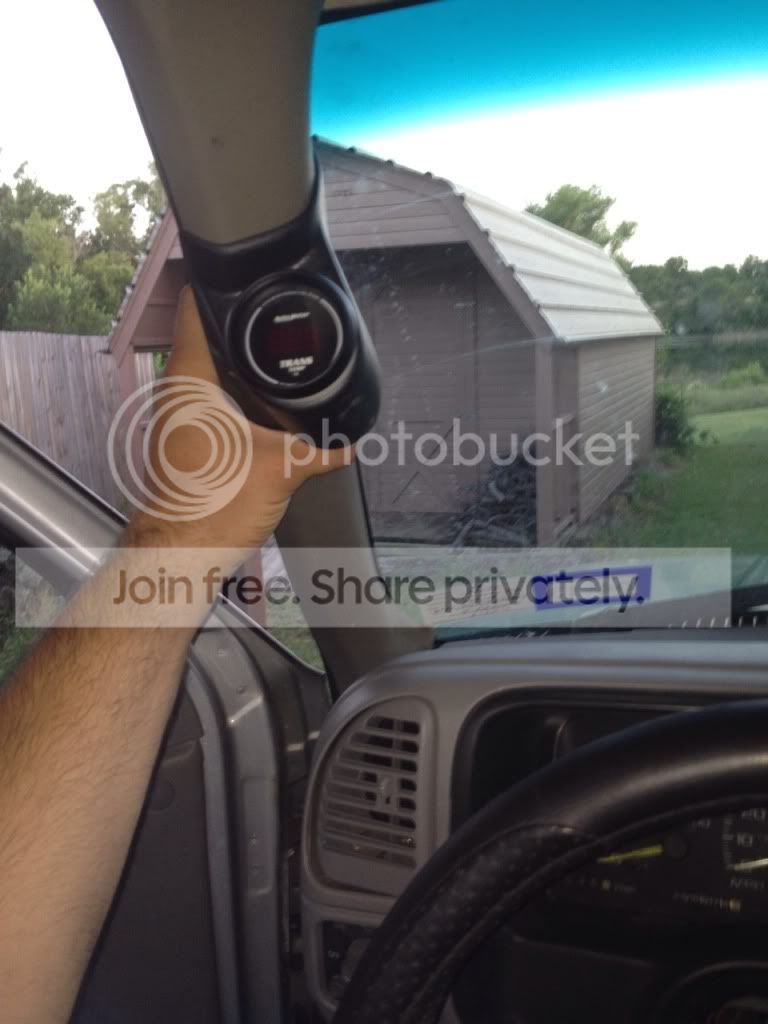

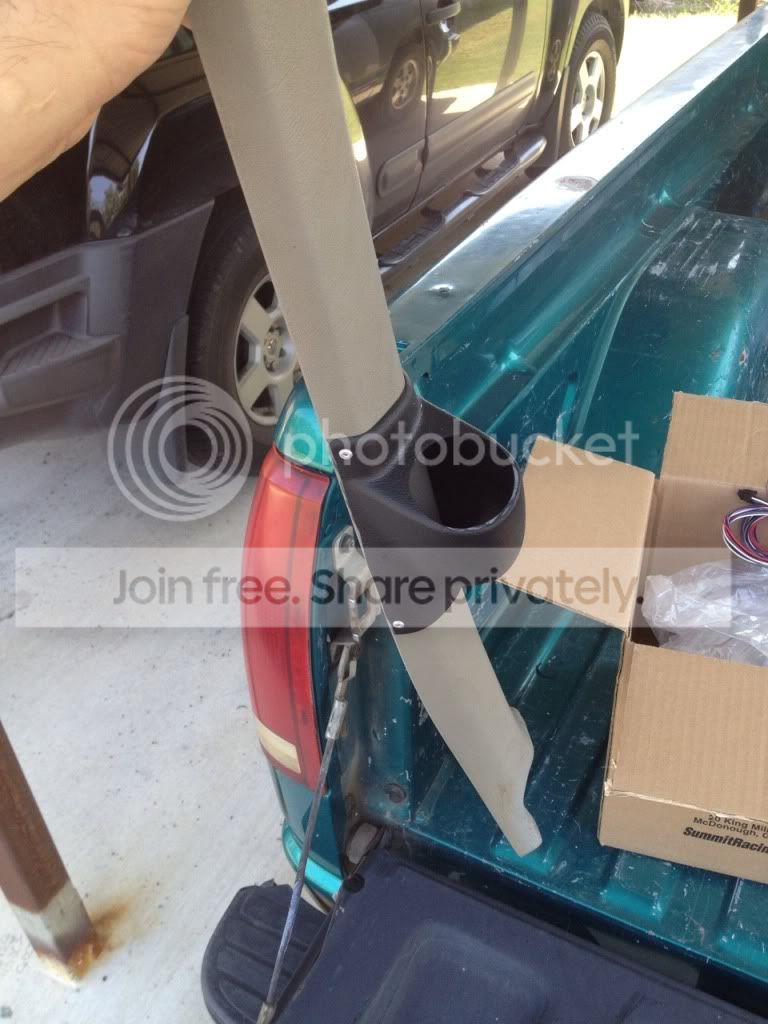

Here are a few pics of the cooler plus some of the trans gauge.
