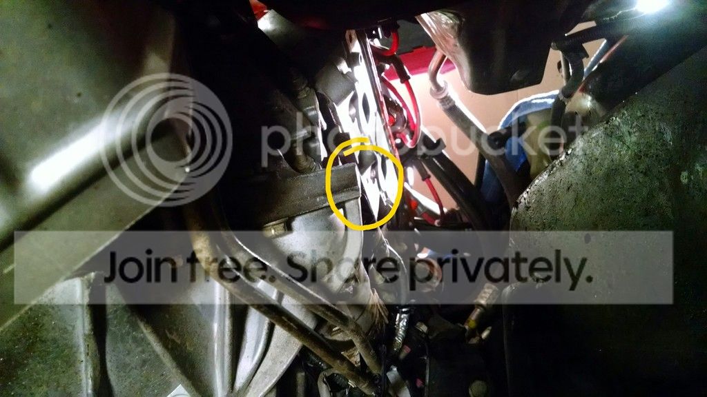

For those of you not familiar with it.. ARH doesn't make 3/4 ton headers. The problem is the 4l80 trans. There is an ear on the transmission that needs to be trimmed off and they go right on.
