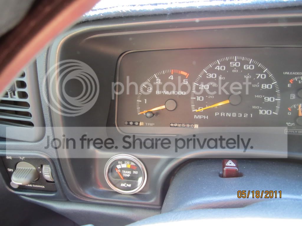

Gary,
Where did you mount your trans gauge and where did you tap it into the trans?
I put the sensor in thru the pan on a flat spot that looked like it was meant for a drain but never put there.I drilled a hole,welded in a bung then screwed the sensor in(Also used some JB Weld for extra security against my lousy welds :D)The gauge Is in the three gauge pod under the dash.The sensor is actually the one for the coolant temp which I had in the engine but disconnected it since I realized the dash gauge was pretty close to the actuall temp.I figured I'd one day use it for the trans temp.
BTW,I picked up an extra trans pan at Pick A Part cuz I didn't want to ruin the good one in case this didn't work.
dirtyoldman
16,510
Saugus,Ca.
Thanks :thumbs:
That location would work if you're not afraid of cutting into the bezel :dunno:
