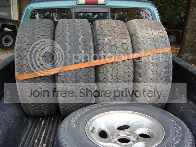

I can no longer wait to do the tires. I now have no spare.
Lonesome7.3
By whatever means necessary …
Mar 25, 2010
3,296
Columbus, GA

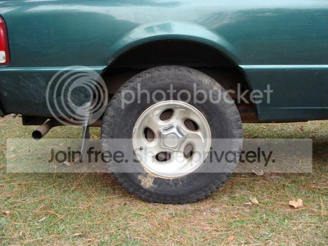

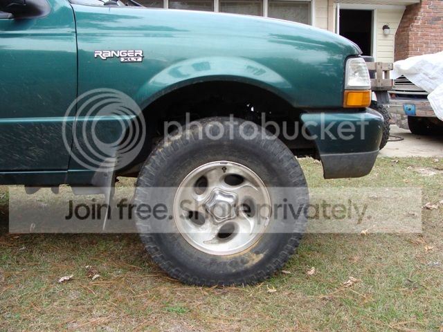

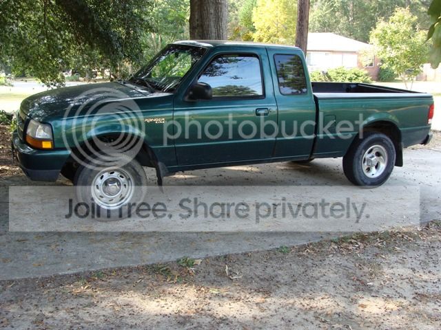

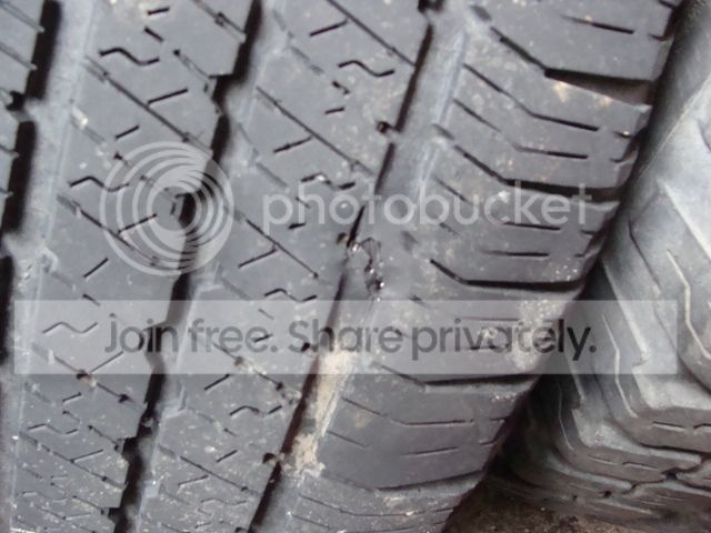

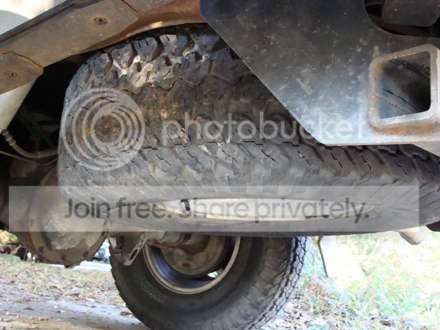

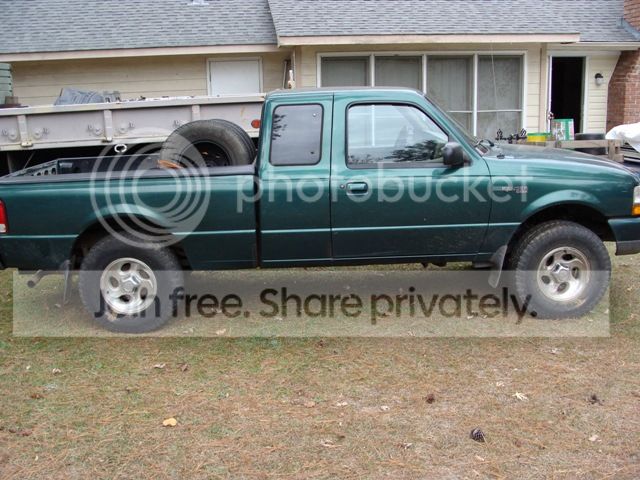

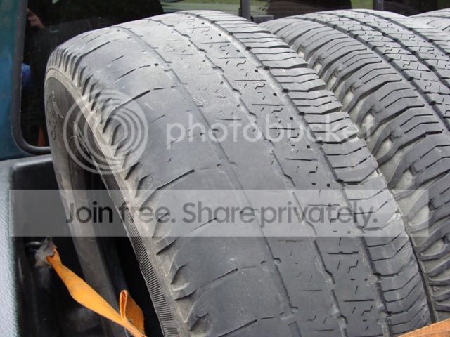

Well, I could not wait any long the get the tires done. Thefront tire was patched some time back and I knew it would not hold forever.Plus two of the rear tires had some uneven wear from a messed up alignment. Iwas hoping to paint the rims before I installed the new tires. That way I did nothave to worry about masking. I will come up with something for the rims at alater date. I think the tires fit great. Even the matching spare tie fits underthe truck perfectly.
Lonesome7.3
Mar 25, 2010
3,296
Columbus, GA
Ride report:
These heavier and thicker tires have balanced out the ridenicely. The truck handle better, hits bumps better and just drives nicer. I amdo not notice any parasitic loss either. I am looking forward to my nest roadtrip to see how they do on the interstate.
