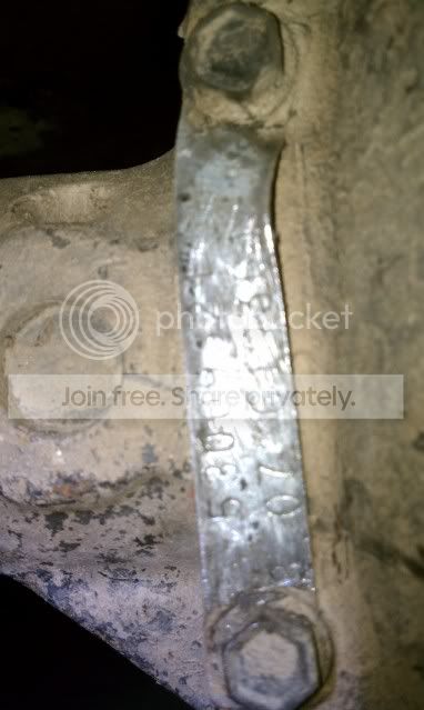

does this mean my gear ratio is 3.07?!
i know the picture isnt great but any help would be appreciated!
I havent ever been able to track down gear ratios by tag number-good luck on that. But the ol spin the tire and watch the turn of the drive shaft does the trick. I beleive you have to turn the power wheel 2 full times and what the shaft turns is your ratio. It works and is pretty dead on-hope that helps ya. Sorry about earlier no hard feelings i hope.
