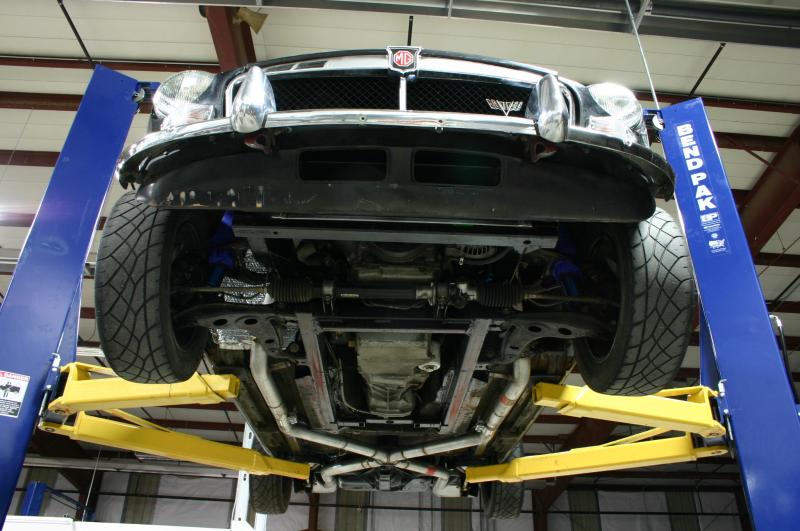

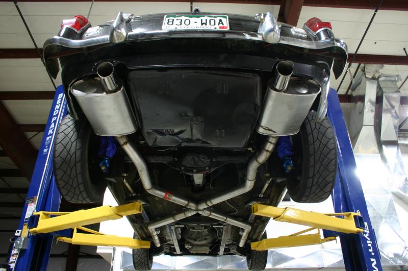

Happy new year :) Dropping in for an update - probably the last one until I paint the car. But I thought you guys might enjoy a peek under the car. I got it on a lift for the first time. It was built on jackstands.
I also dropped it on the scales. 2378 lbs with an almost-full tank of gas and a spare tire - full street trim. 51.9% of the weight is on the front wheels. Now if only the weather will warm up so I can use full throttle in at least one gear. I lit the tires up in fourth at about half throttle driving to work yesterday...
