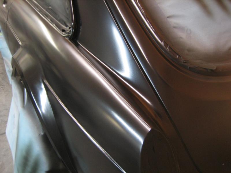

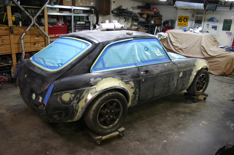

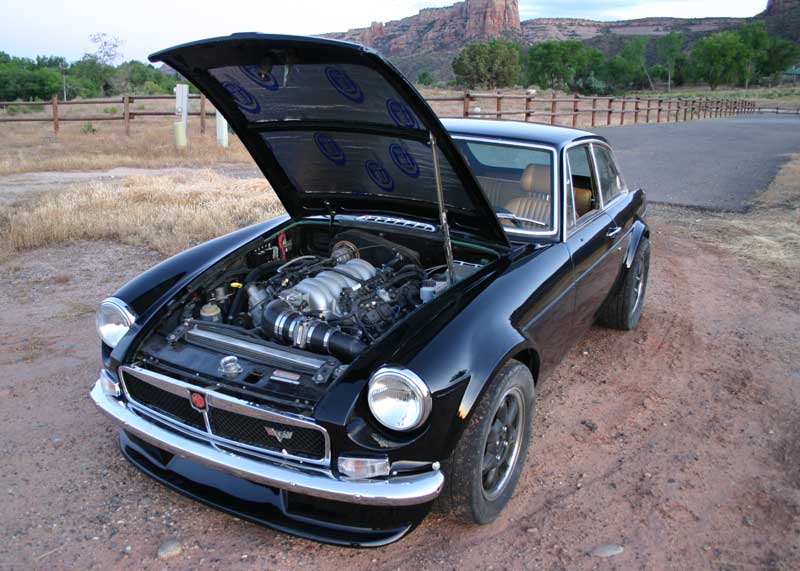

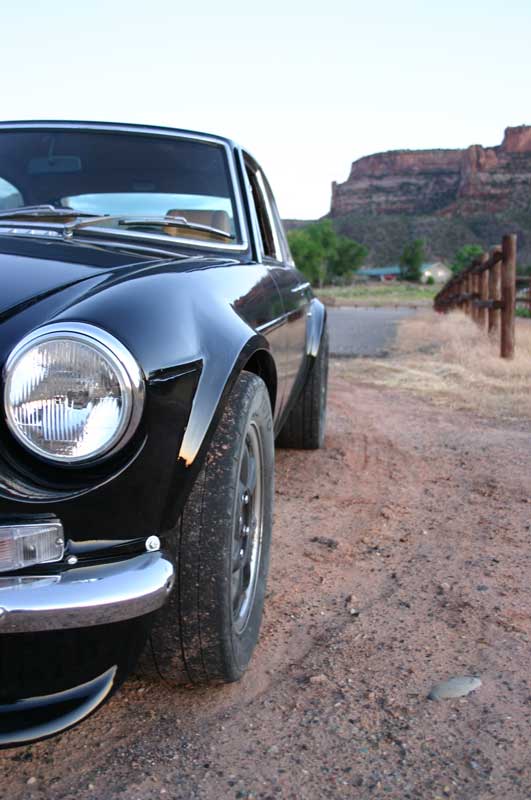

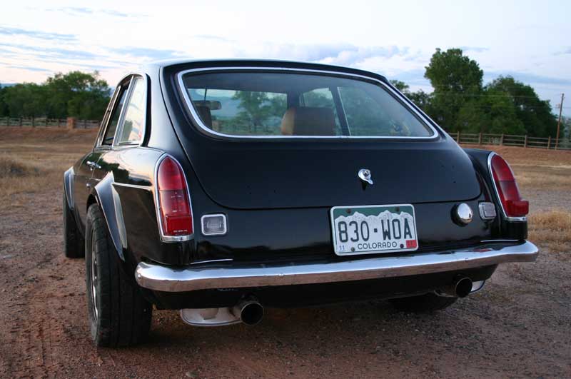

I've been working on a few other things - including my L33-powered Miata racer - but the MG finally took a big step. In mid-March, I started working on the bodywork. The shell's amazingly rust-free for a 39-year-old British car, but it has been painted at least twice over the years and also accumulated a lot of nicks and chips and a few dings. The black paint was badly sunburned. Plus the flares needed to be blended in to the body.

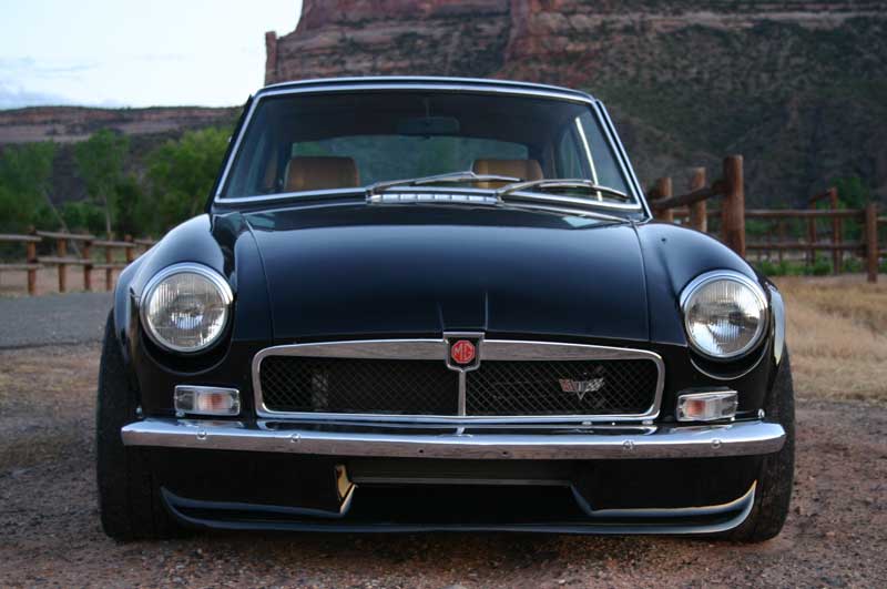

So I stripped the car down and started layering on filler, then sanding most of it off, then layering on a bit more. The whole car is compound curves which made things interesting. I've done almost no bodywork before, so there was a lot of learning going on. A D/A sander from Harbor Freight was the big breakthrough, allowing me to make much better shapes, faster, than I could by hand. I reworked the right front flare with steel first to fix the shape, it wasn't quite muscular enough. The car's also wearing an MG Special Tuning front air dam, which balances the look of the front end. Plus it looks totally badass.
Finally, last week, I laid down a few coats of BMW Jet Black. It's not perfect, but it'll come to life nicely with some buffing and sanding. I'll put the mirrors, rear badges and chrome side strips on once that's done.

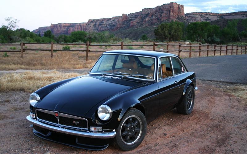

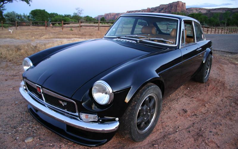

And now, the car.
I've still got a way to go. I think it's going to get stiffer springs all the way around to see how that works out, and I still need to spend some time tuning the car on track. I have a Miata front sway bar adapted in the front so I have access to a wide variety of options. Nothing in the rear yet, but I'll fit the Camaro one if I need some more rear roll stiffness.
Video will come soon hopefully. But right now, I'm just enjoying the car. Holy cow, it moves.

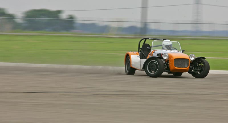

The Seven, a Lotus Seven replica built around a Miata drivetrain. This is the one that took on the Atom. It's also the subject of a book.

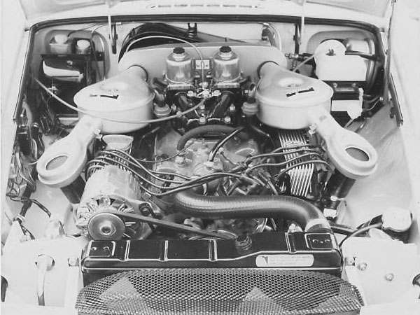

Lovin the Dual SU carbs!!
