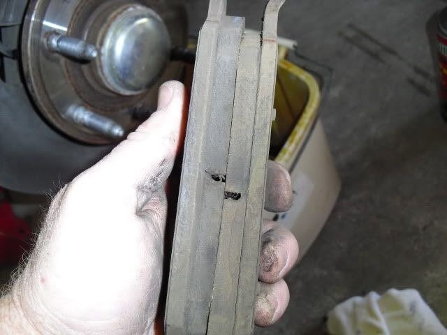

How to do a brake job on GMT-800, 2006 Chevy Silverado
Nice write up and pictures. Thanks for posting. The only thing I would suggest different is not reusing the old rotors. When a shop 'turns' a rotor, they take metal off. Each bit of metal taken off is less thats able to absorb heat, leading to warped rotors. Plus, with 96K on them, I think you got your money out of them.

That thought did cross my mind. My reasoning behind behind re-using the old ones: When new my rotors measured 1.200" and after facing them they were at 1.160". My thought process was how much difference can 0.040" make? :dunno:
With the rear drums I never got a measurement on them since I don't an inside mic. large enough to get them.:dunno:

I highly recommend taking the caliper off of the arbor. Then you can take out the slides, clean the old/burnt lube off of them and reapply fresh lube.
Also, if new metal brake slides don't come with the new brake pads, I take a wire brush to them to clean off all of the rust & debris, and often apply a touch of lube to the mating surfaces there as well.
Two common brake problems I see in the shop are due to the caliper slides seizing up or the brake pads seizing; both of which are preventable with a few extra cleaning/lubing steps.
