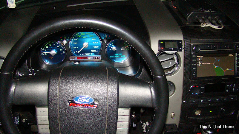

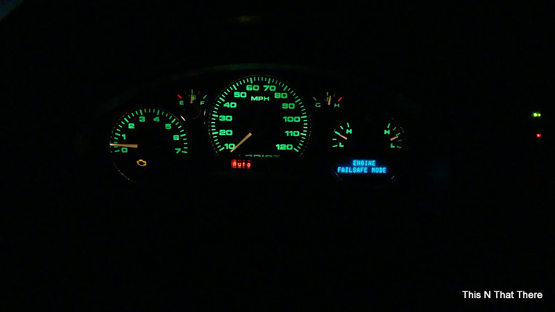

Well so far I took the truck to the nearest Ford dealer 31 miles away. I was able to get to the dealer this Monday morning but they were unable to communicate from the PCM to the scanner. So I towed it to Fairway Ford Performance since they know my truck and all the wiring schematic. So far I'm still waiting to hear from them on what the problem is. Soon as I hear from them I'll be updating the thread. Again thank you all for lending a helping, you are all such great friends and I'm a honored to have you all in my life. :cheers:
Error message display:

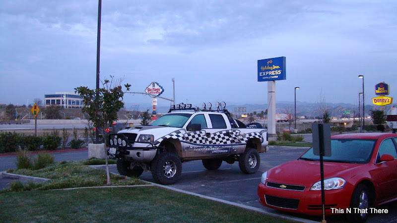

The truck was able to make it to the Holiday In next to Six Flag California:

Based on what has been said...and the codes...my money is on the cam position sensors or associated wiring.
Either one of the P0010 or the P0020 codes, will throw it into "Failsafe Mode."
Since he has both...I would figure the wiring going to them has a problem. :dunno:
It is possible, but very unlikely that both cam position sensors would fail at the same time.
