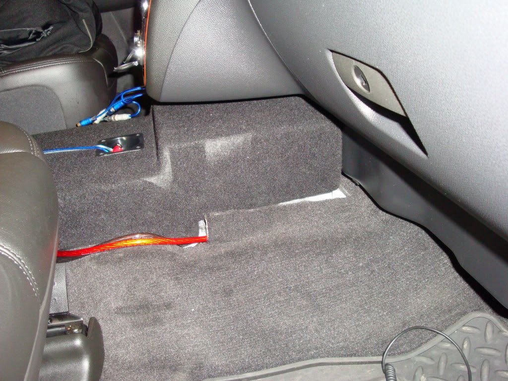

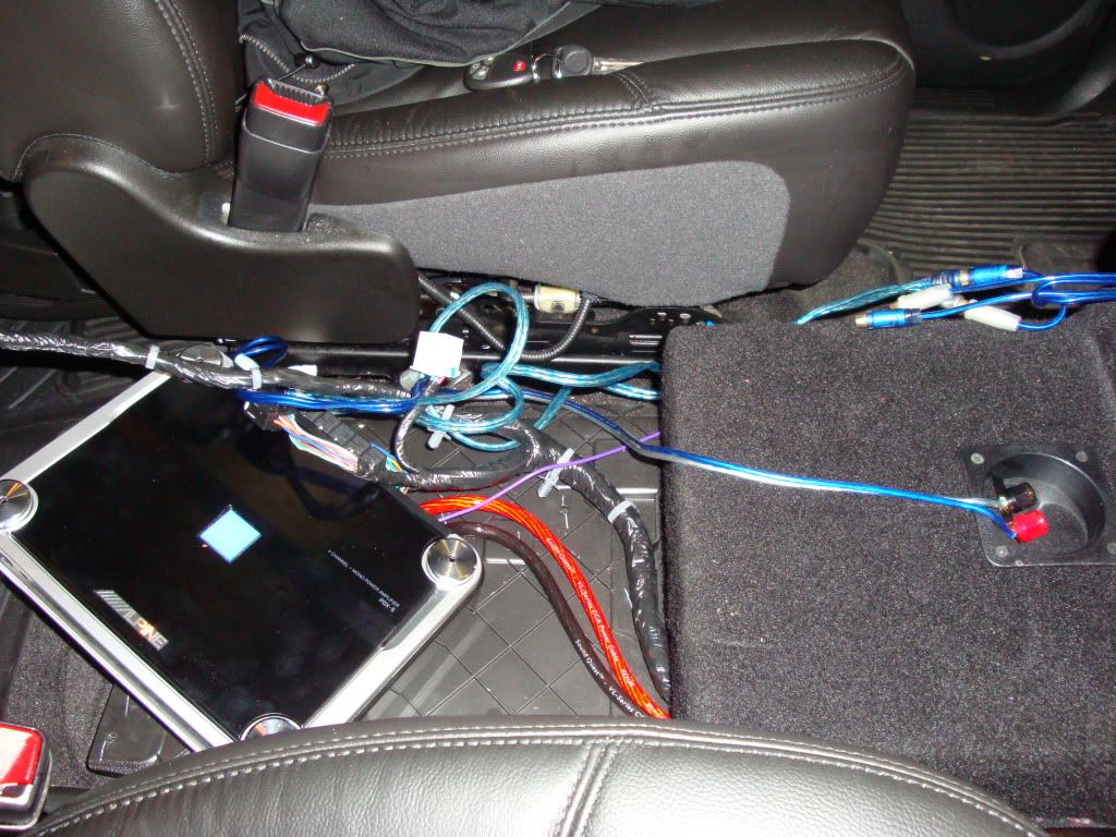

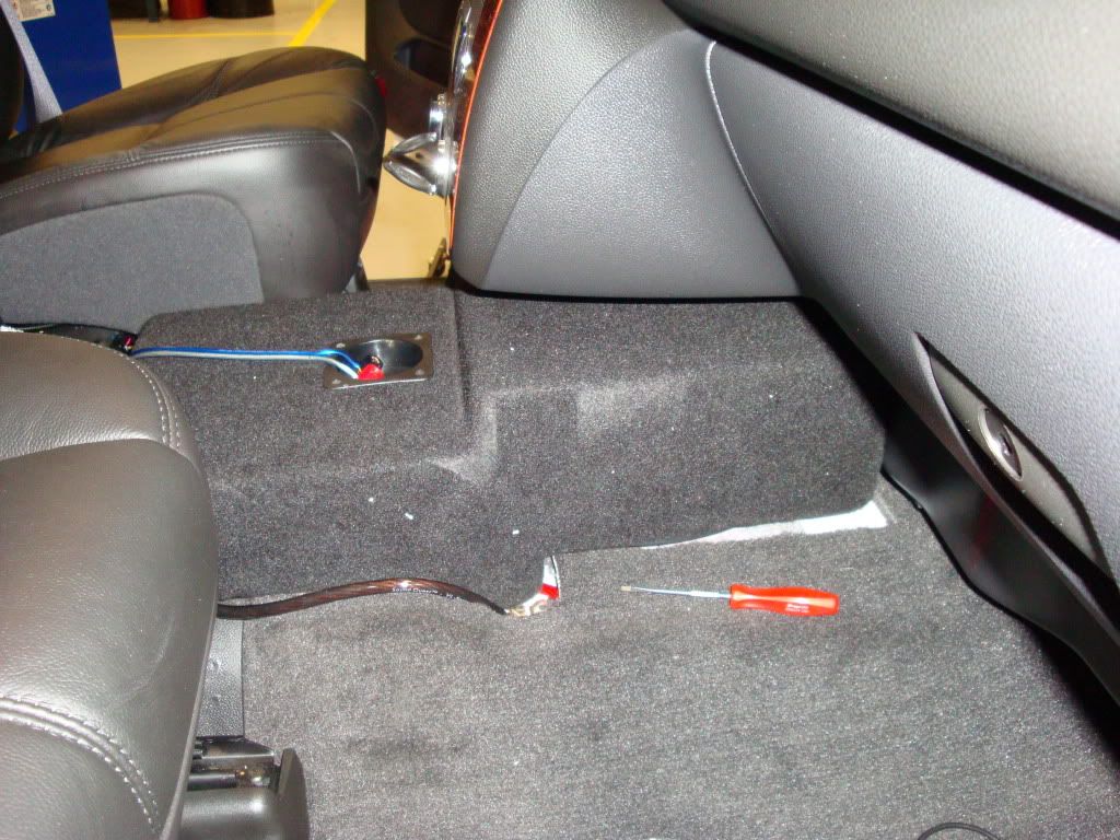

Amp sitting in the console enclosure, where the bose amp was:

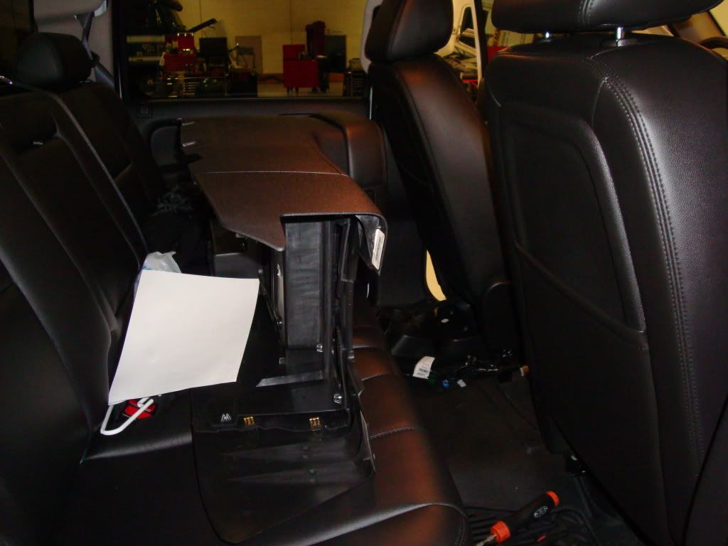

Stealthbox is exposed with console removed:

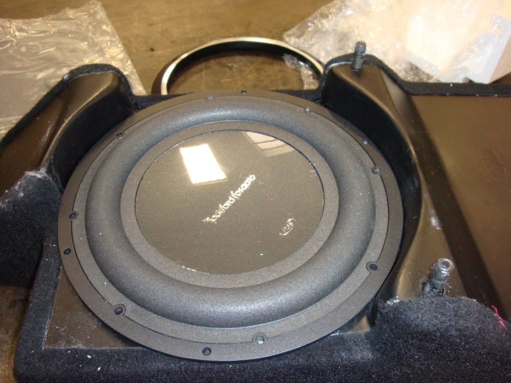

Stealthobox removed, has a W1V2 in it:

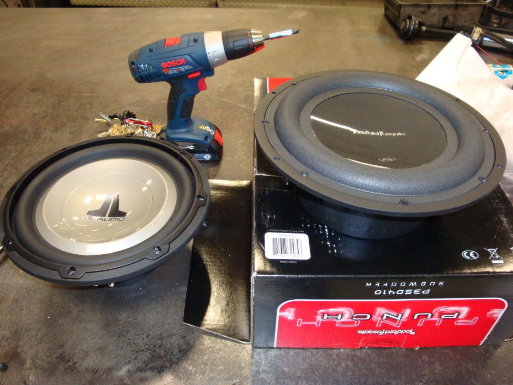

Here is the new Shallow Punch P3 next to the JL:

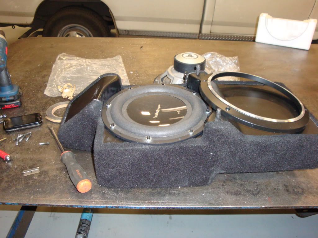

Wired the DVC Punch for 2 ohms and dropped it in:
The Punch retaining ring wont fit in this recess, so I just put some butyl sealant on the flange and sealed it to the enclosure, and threw some washers on the screws:
Got it back in and bolted down, sealed the bolts, set the gains and filters, and let it rock
In the morning I will make up my mind what I want to do with this mess.
One thing is for sure, all the speakers are done, all running 2 ohm, and all sound great!
