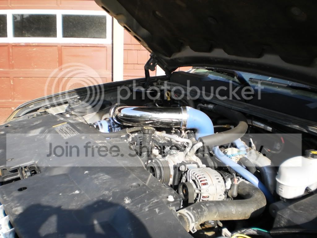

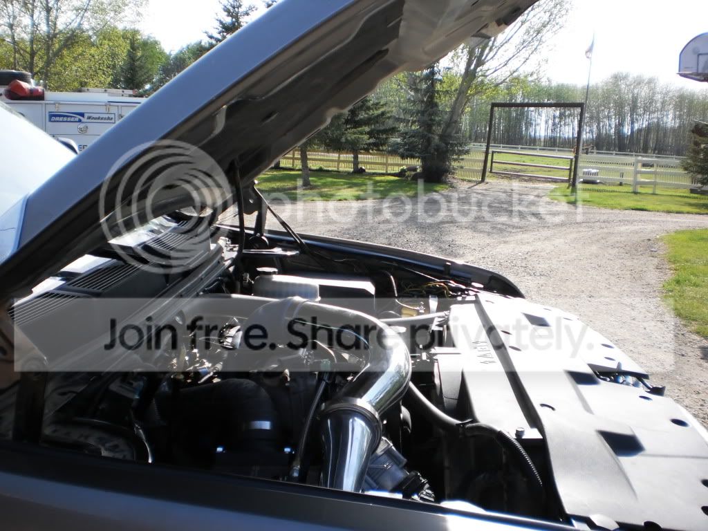

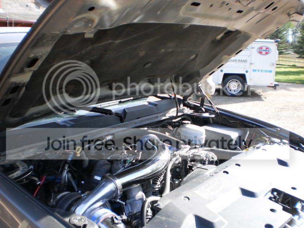

Pics of it below, i have rode with cole in the truck, that thing is insane, he cranked it to level VI and i couldn`t lean forward enough to even look in the passenger mirror to see all the smoke! :crackup:
