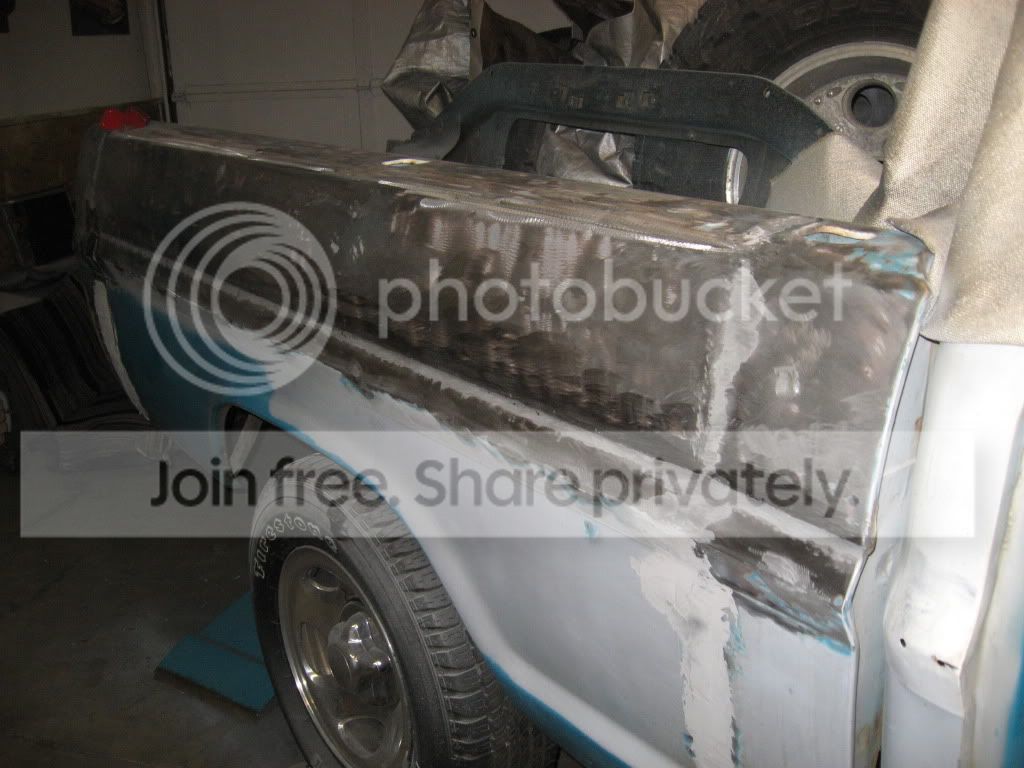

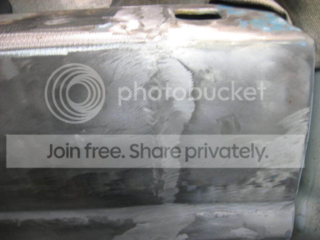

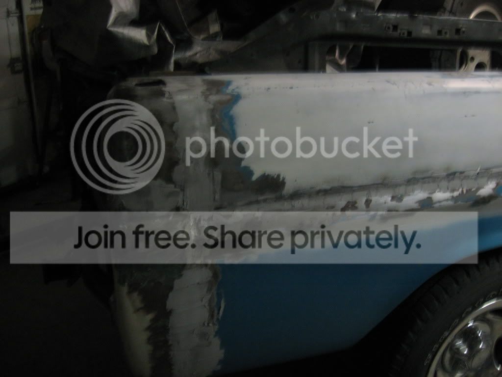

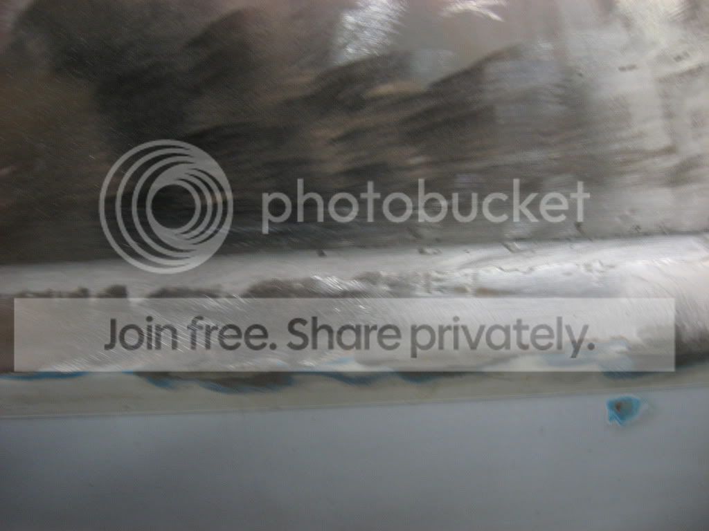

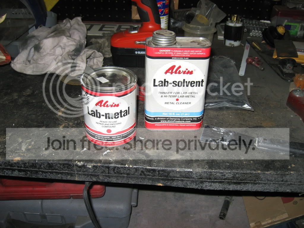

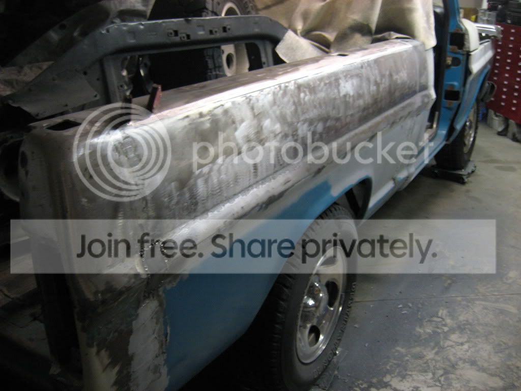

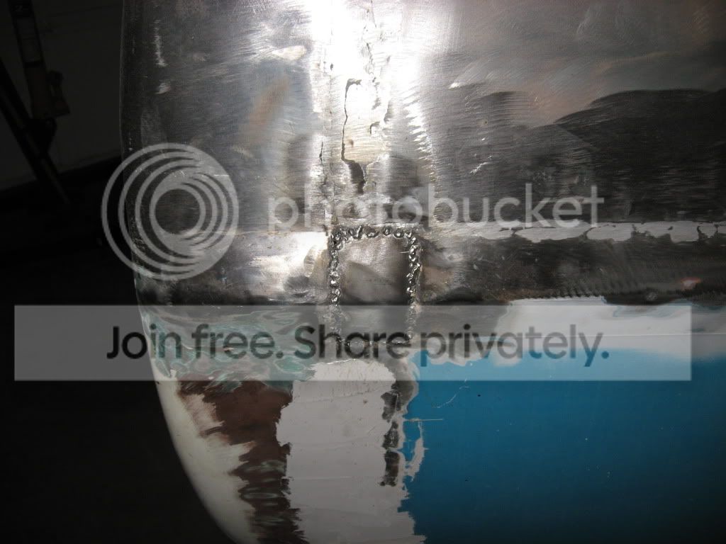

I finally finished welding away at the bed seem on the passenger side so I got out my grinder and went at it smoothing all the welds then pulled out the metal filler and went to town spreading it on.
It's a great product that I've used on other projects and it holds up very well and is very metal like once it hardens. Also a very good way to smooth out spot welds on sheet metal.
Almost looks like metal to.

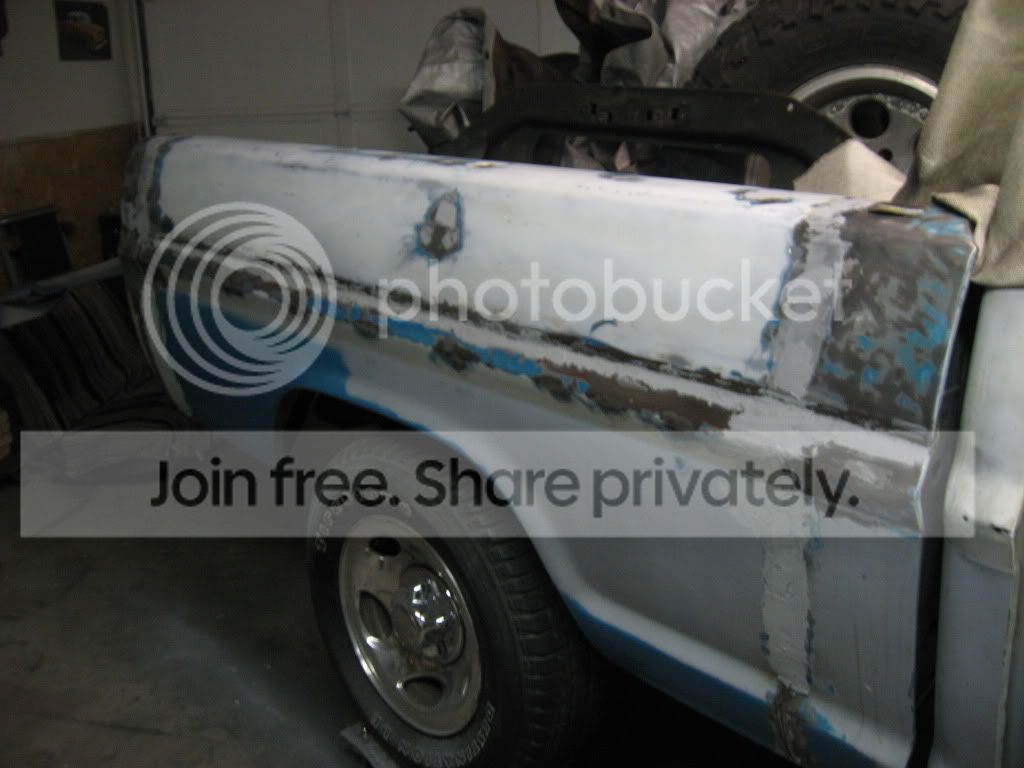

had a spot of rust that was a little worse then I first thought so I cut it out and welded in a patch.
The ruffed in body work is done around the seem, so that should do for now. I kinda find myself bouncing around on this project but it keeps it interesting for now....
