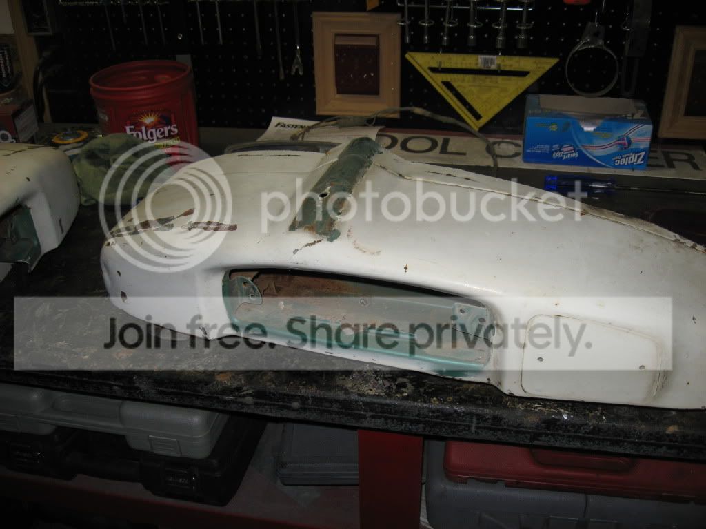

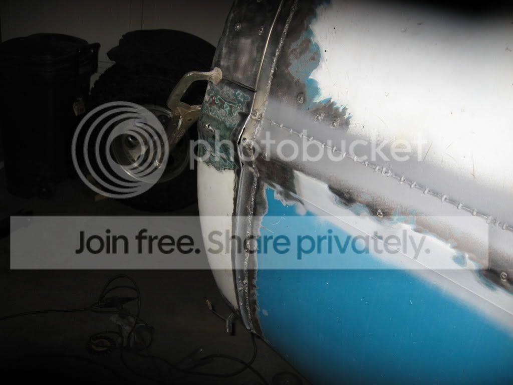

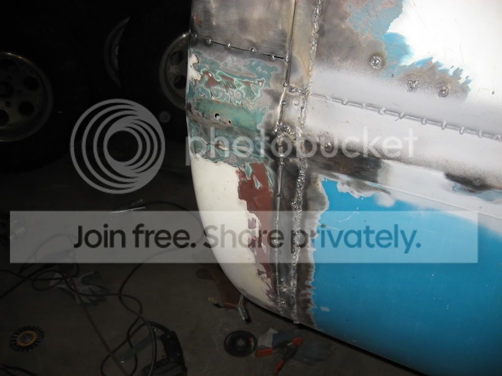

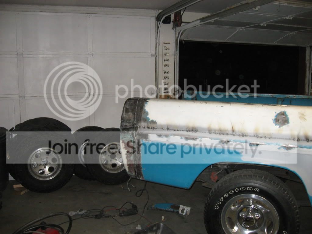

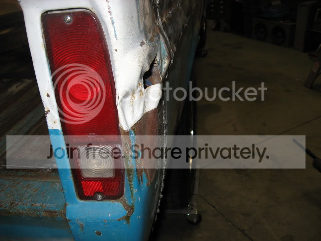

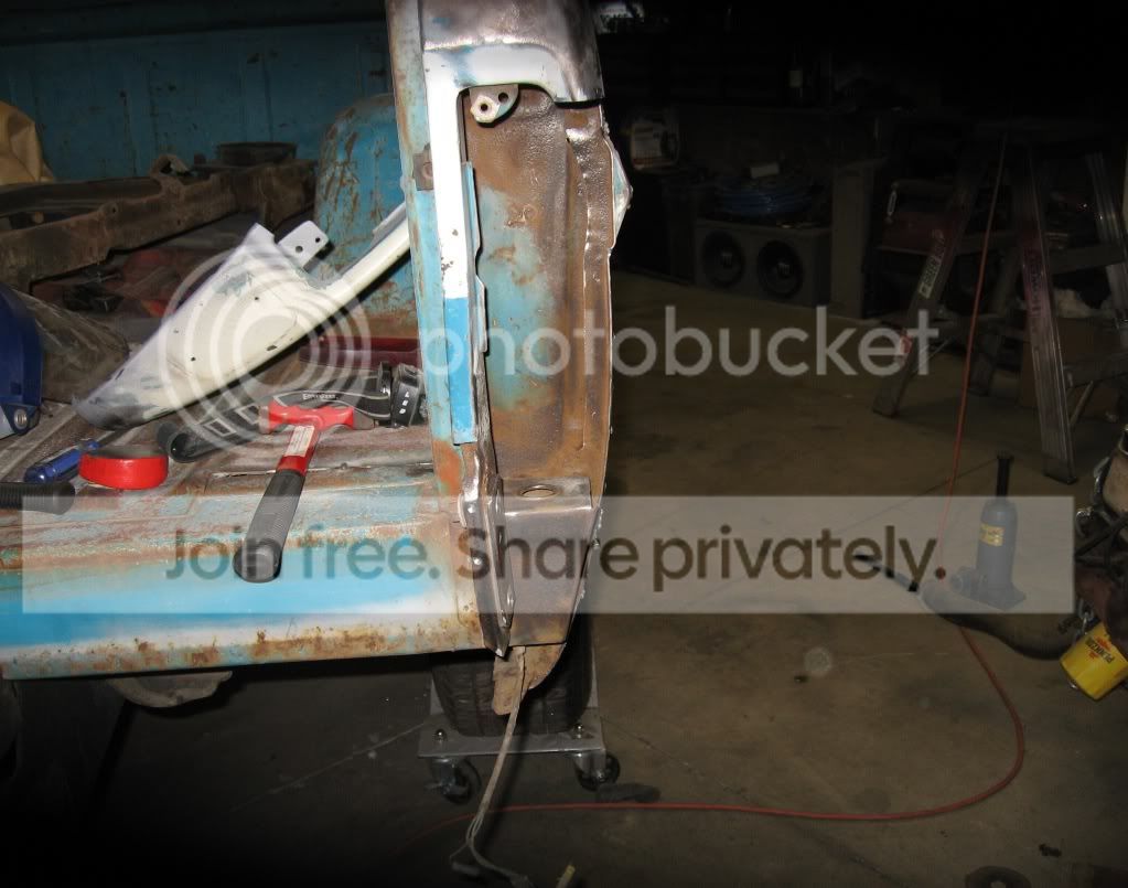

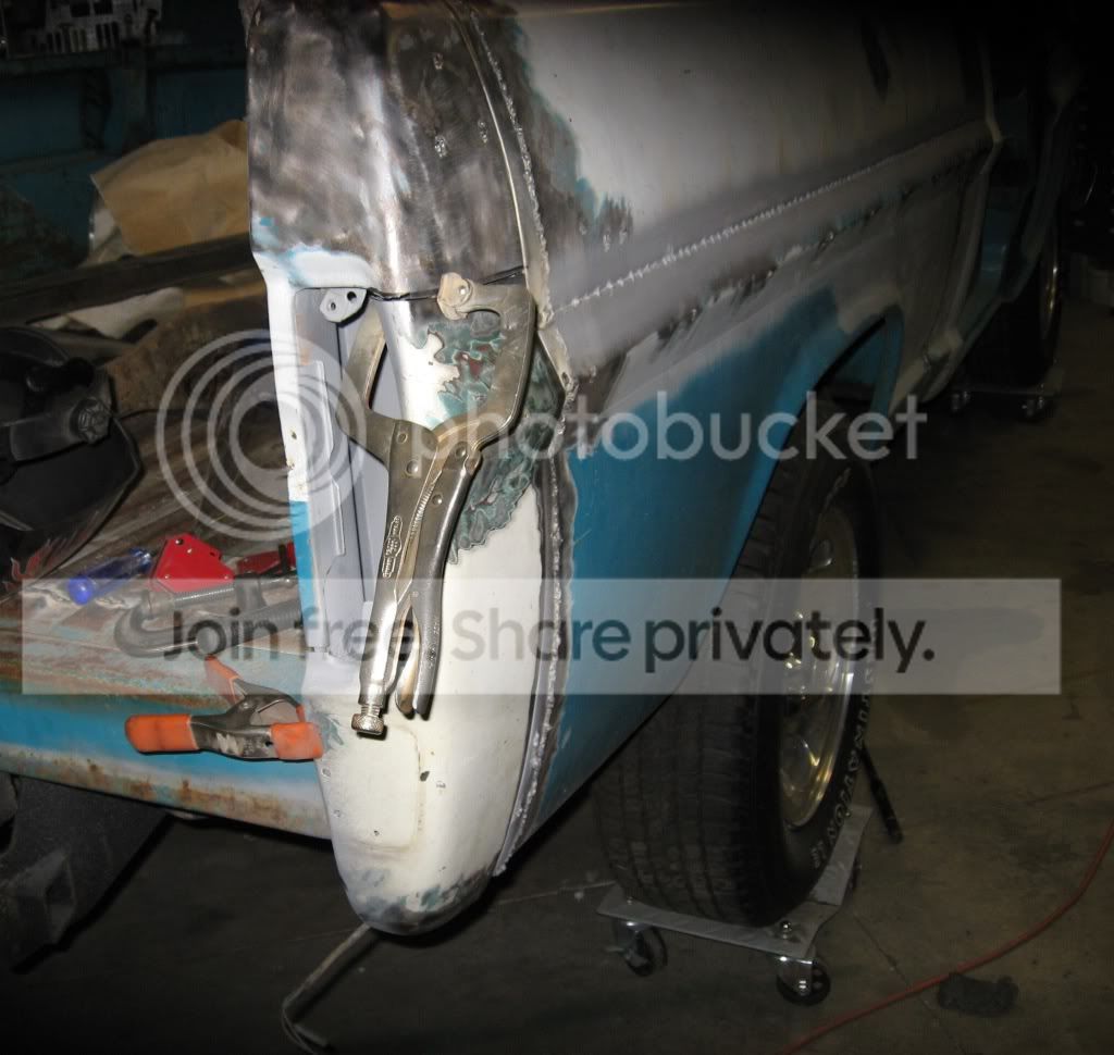

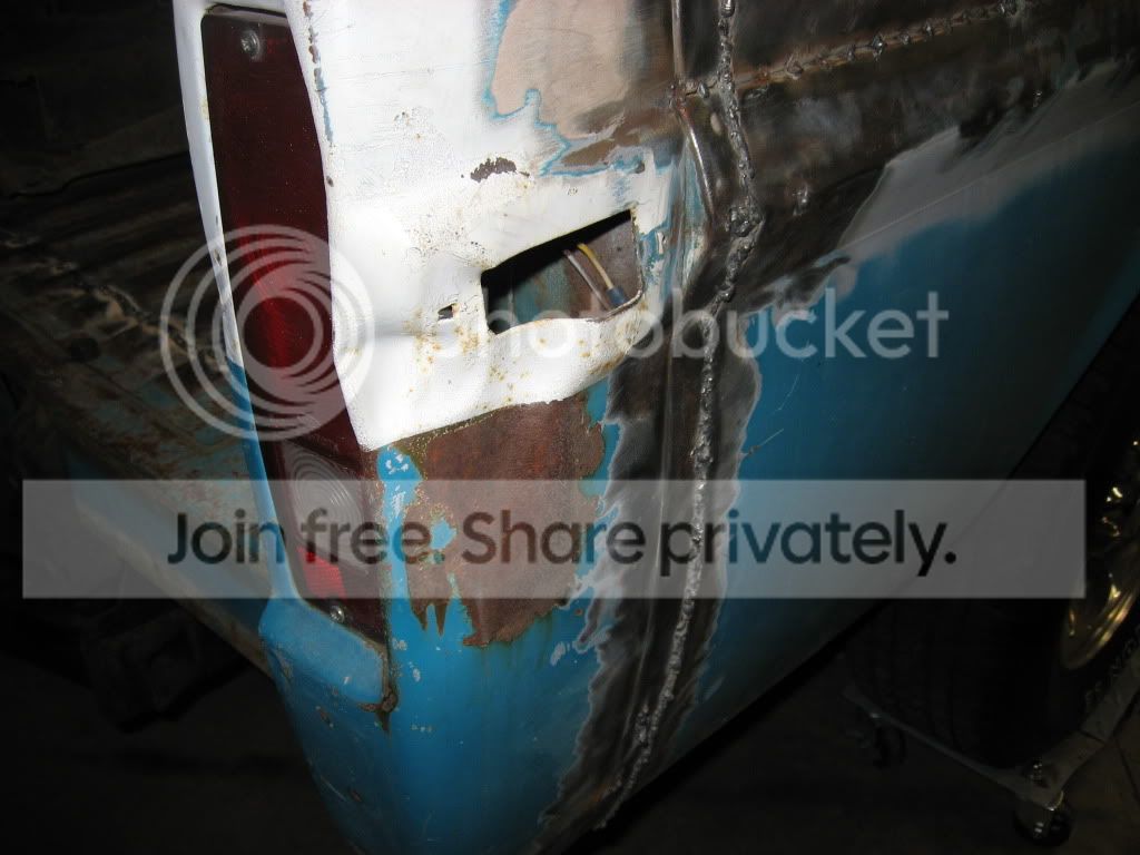

Well I got a little more done today, I figured now was as good a time as any to fix the nice dent the truck had when I bought it.

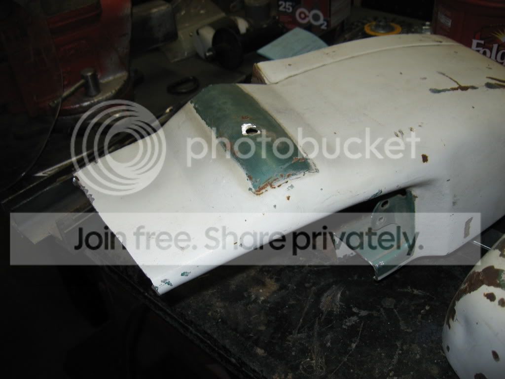

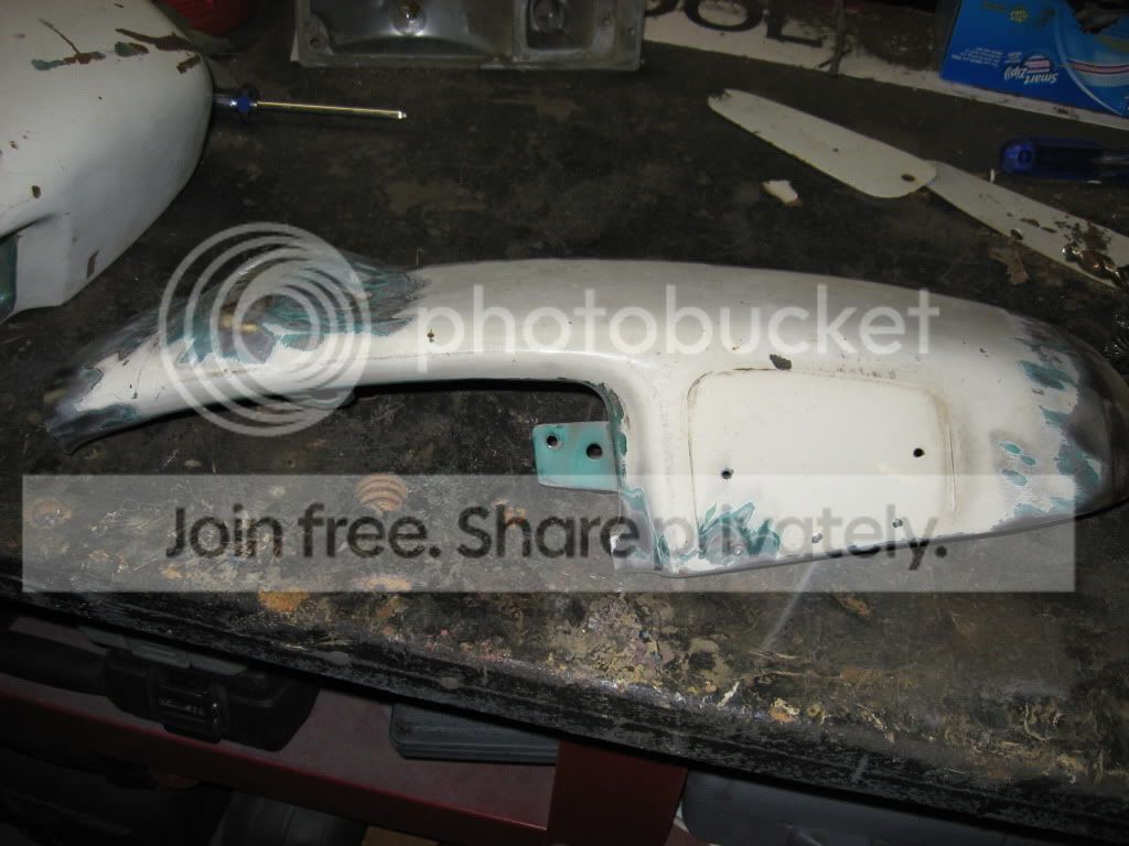

Also going to use panels from a 67 to fix it so the bed will have a more smooth look to it. I picked these corner post up from a junk yard for $10 ea.

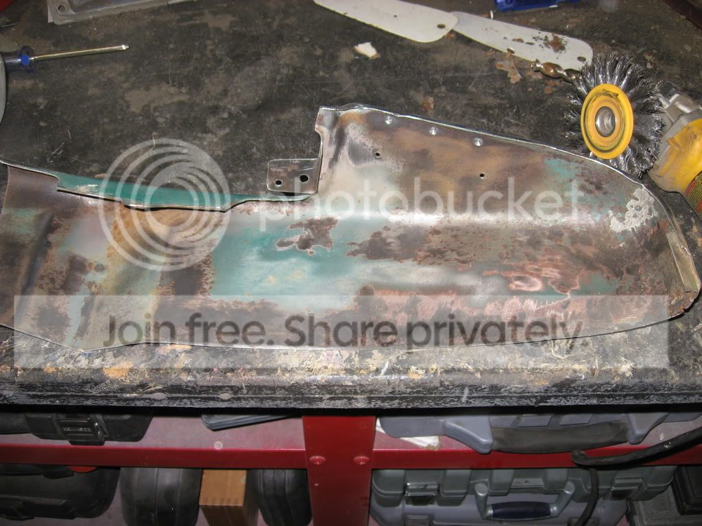

Cut out my patch panel and then cut out the damaged panel on the truck.

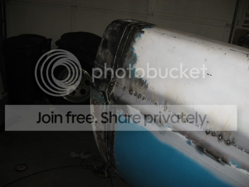

Clamped in the new patch and then started tacking it in.

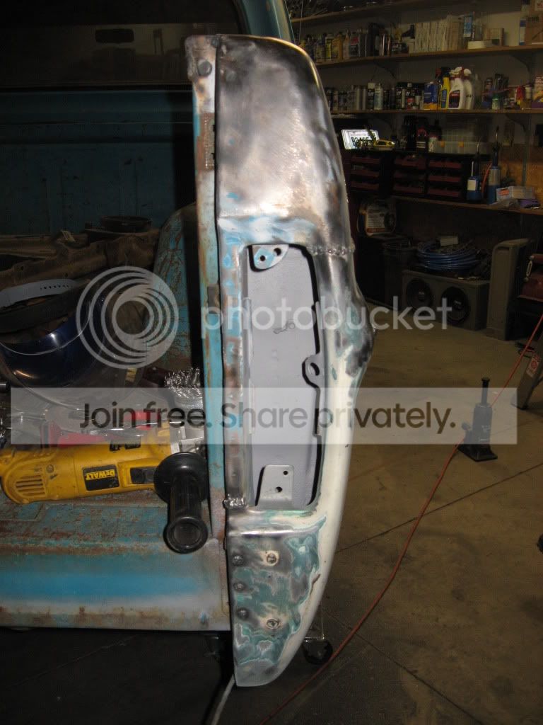

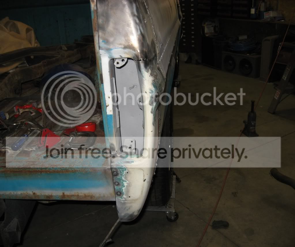

So after a ton of spot welds it is done.
Now I get to start the drivers side :uhoh:
