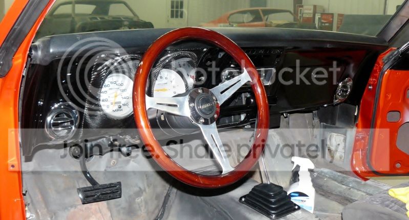

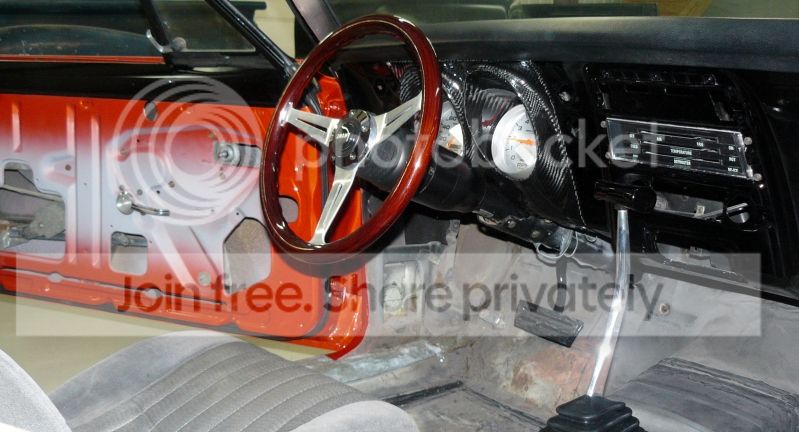

I think it's a linkage issue also. If you have plans to go floor shifter let me know. I have one of these and will let it go for $120.00 shipped.
B&M Unimatic: http://bmracing.com/?wpsc-product=unimatic-shifter
Was installed in my 67 Camaro but I needed another shifter to be legal at the drag strip. Car was never ran with it. Cable is still in the sealed bag.
