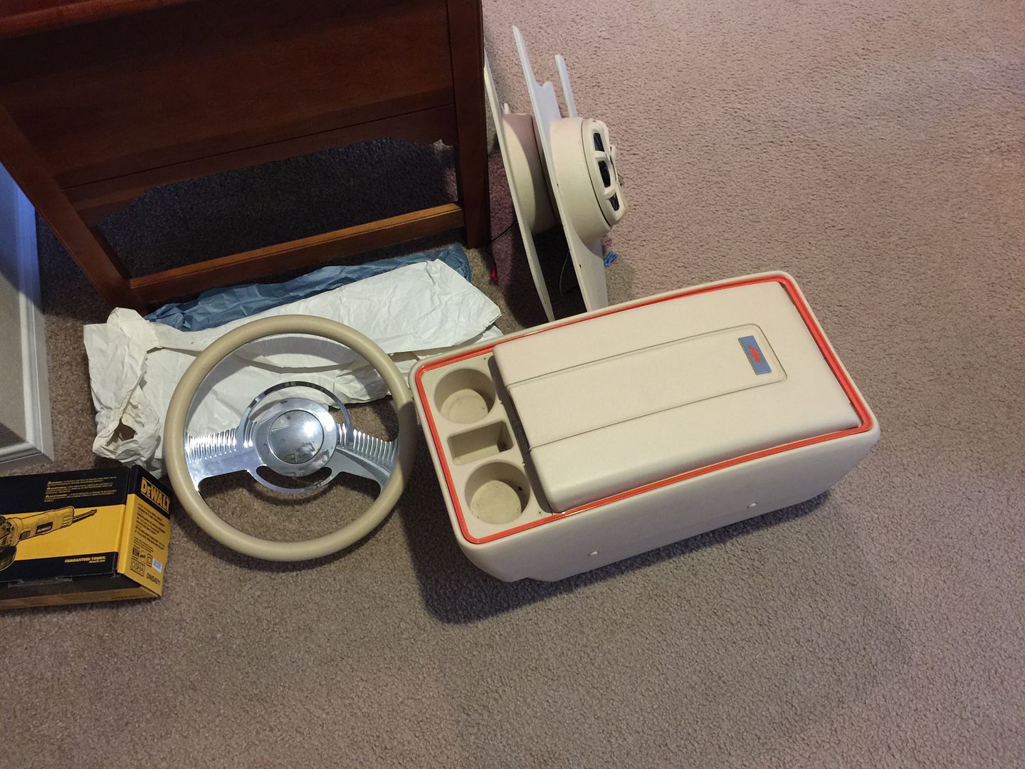

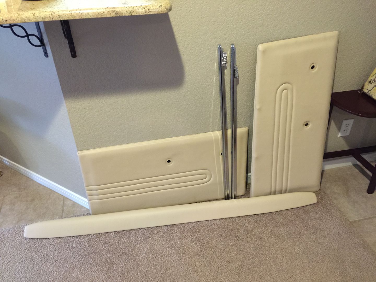

Picked up my interior from him while I was there, a couple of pics but I never took any of the seats. :uhoh:

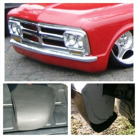

I decided I want to go with a front roll pan so I got in touch with Grant Kustoms and they are making me the front roll pan and fender cups. The fender cups extend the front edge of the fenders down 2 inches to make up the gap when the truck is laid out.
The front bumper is a modified 67 Camaro bumper that I'll attempt to duplicate. Have to add 14 inches in the middle and reshape the corners.. A pic from there site on a GMC..

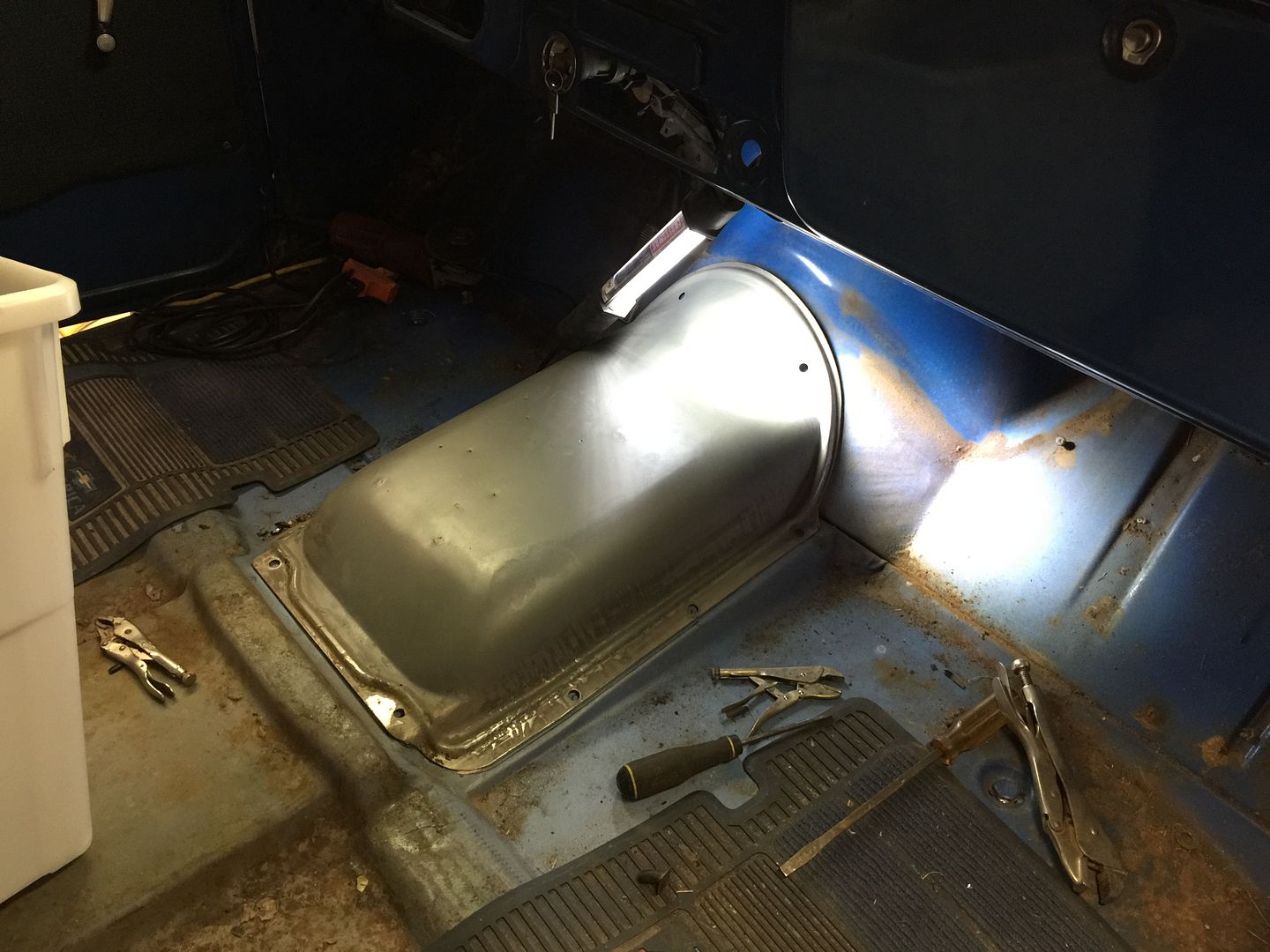

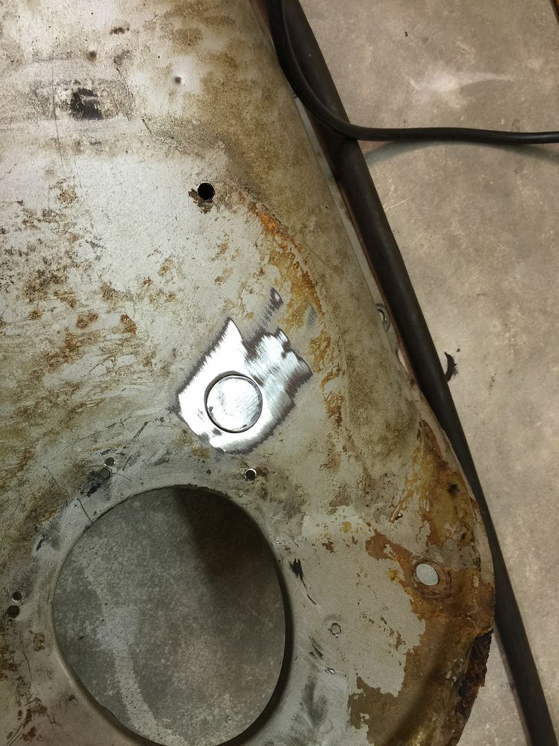

Started patching the holes in my high hump cover, only got one pic of the fit up but I had several holes to fill and a couple of patches to make.

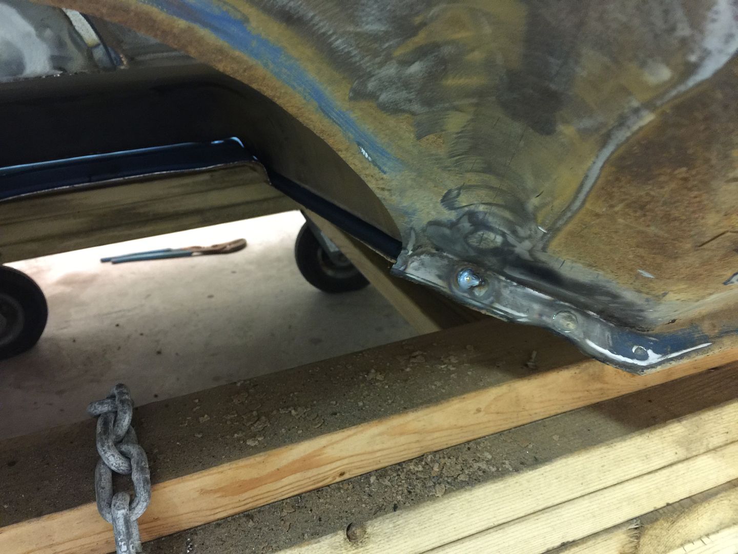

Cut the floor out and still have to get the fit right. The seam between the floor pan and toeboard was off about 3/16" from the factory. With carpet in place you would never notice, but trying to fit the hump in it was really throwing things out of whack.
So I drilled out the factory spot welds at the seam and repositioned it.
