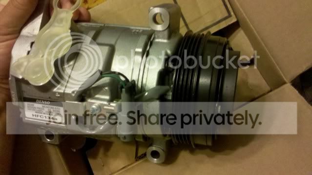

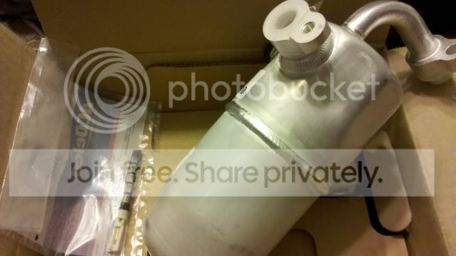

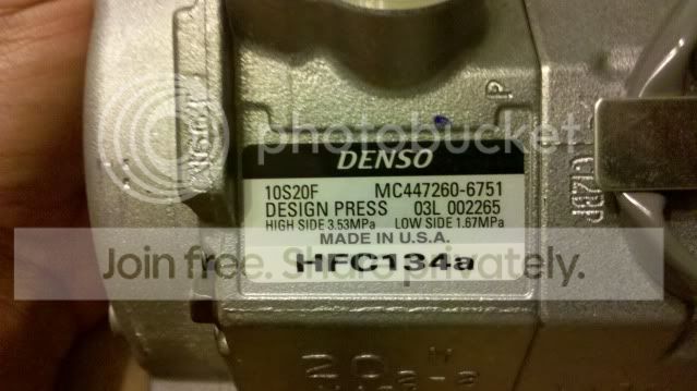

I did end up getting everything from Rockauto. I know how you guys are picture whores, so here are some pictures of the goods. I got all AC-Delco parts. I knew Denso made the Delco compressors but I didn't know I would be getting an actual Denso compressor in a Delco box. :dunno: Either way, I am glad I bought this versus a cheap aftermarket or Reman unit. :thumbs:

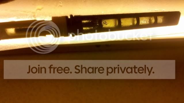

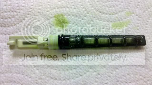

The guy at the shop is really cool. He explained to me that if the orifice tube is really dirty, then I should tape up the ends of all the AC hoses and bring the truck back to him so he can flush it. I asked him what exactly is "really dirty"? And he said "oh, you will know! Sometimes it looks like mud and shit packed in there. "
So what do you guys think? I don't see any dirt or crap, but I do see some metal flakes. :dunno:
