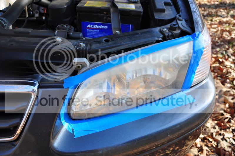

Since I'm home for the week I decided to clear up the headlights on my mother's 2001 Toyota Camry. I know a lot of us have newer vehicles and don't have to worry about this (yet), but many of you own several vehicles. This should help if your headlights have that nasty, yellow, "cloudy" look, as such:

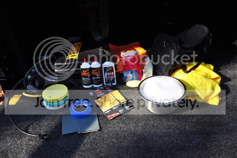

(again, this is what I used)
Materials:
1. Bowl or bucket filled with soapy water
2. Some old rags (type doesn't matter)
3. 1000 grit sandpaper
4. 2000 grit sandpaper
5. Masking tape (I used blue painter's)
6. DA polisher
7. M105 + heavy cut pad
8. M205 + light cut pad
9. Plast-X + foam hand pad
10. Latex Gloves

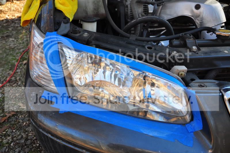

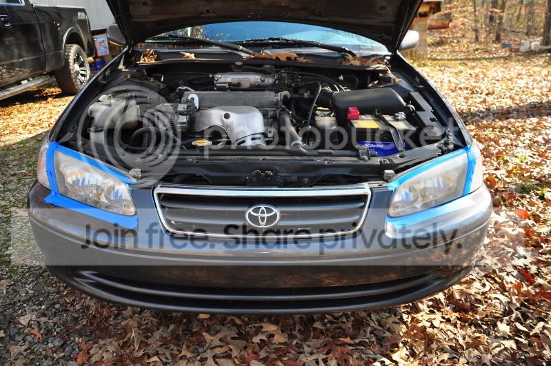

2. Use the masking tape and tape off areas you don't want to accidentally wet-sand or have polish get into.

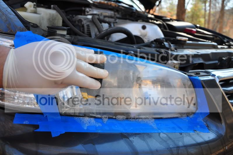

3. Wet sand with 1000 grit first. Work in straight lines, first horizontally then vertically. How much you need to sand depends on how bad of shape your headlights are in, but it's mostly a feel thing. Just do what you think is enough.

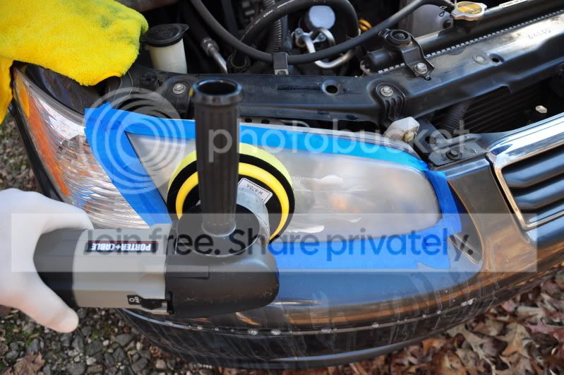

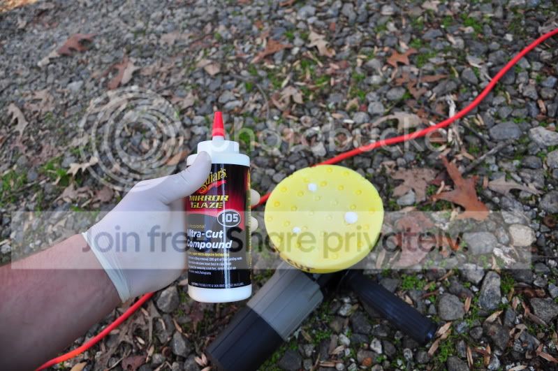

6. Use the M105 with a heavy-cut pad. You shouldn't really worry about screwing anything up since headlights are far less prone to damage than paint. Put a few drops of M105 on the pad.
7. Spread it around by hand first to prevent slinging the polish everywhere. After spreading it around by hand use a low-speed setting (2 on the PC) to spread it evenly.
8. Turn the polisher up (5 on the PC) and go to town. Work it around evenly and slowly. No need to go fast as there isn't much ground to cover. After working it for a minute or so go ahead and wipe it off to take a look.

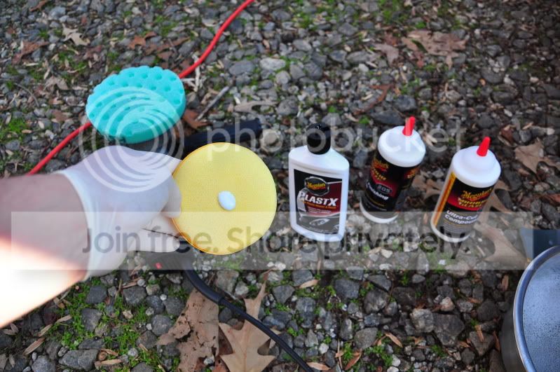

9. If it looks pretty clear (mine did after the M105 alone) use the M205 the exact same way as the M105. This time use the light-cut pad. If it still looks pretty foggy from the wet sanding then do another pass or two.
10. Wipe off the M205 and put a small drop of Plast-X on the foam hand pad to work in by hand. Spread it around and rub it in.

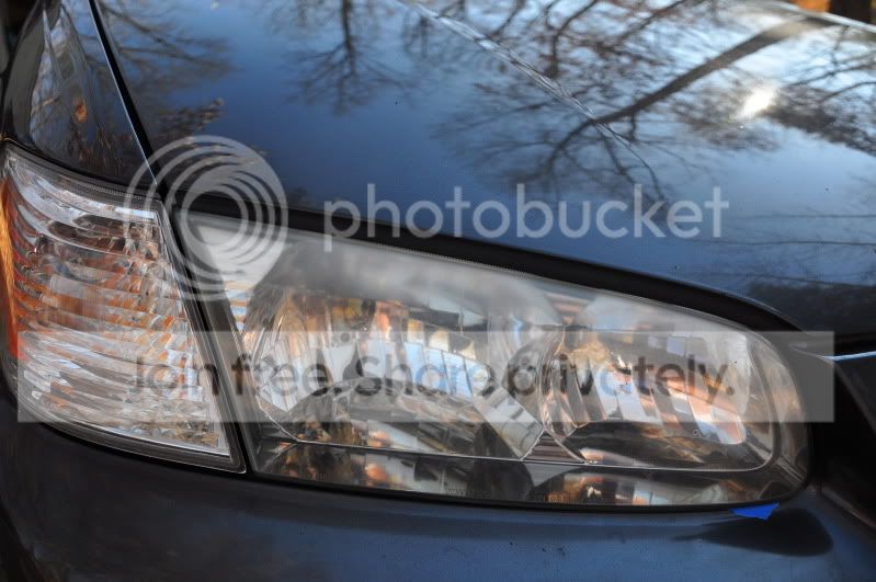

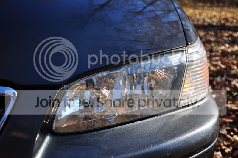

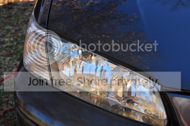

Here are a few comparison shots after the first headlight was finished (I did the passenger side first, obviously):
Before and Afters:
Final thoughts:
I feel I could have gotten away with using just 2000 grit and M105. If you're short on stock or cheap feel free to try it this way and report back to us. After I used the M105 the headlight was pretty clear. I just used the extra stuff because I had already taken the time to pack it up and take it home in the first place.
