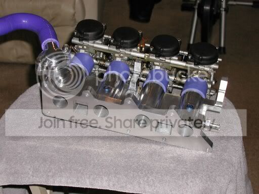

6061 Aluminum Intake
This was done manually on a Milling Machine there was No Cad was used. It took 260 machining hours just for the intake.
( This ways a solid block and weighed 35 pounds )
When it was finished it was 8 pounds

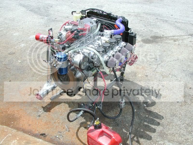

These little motors haven't go a lot of HP but are reliable.
With the mods that were done along with the intake and bike carbs the HP was doubled. There still isn't a massive amount of HP about 120. It should get out of its own way even with the big tires and not break anything.
