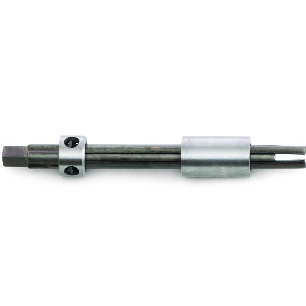

Get a broken tap remover. They are awesome
If I was anywhere near my box I would send you one to borrow
I'm actually headed to Lowes to see if I can find one or a heavy duty snap ring tool, I might be able to get the prongs down on either side and crank.

I ended up ordering a broken tap extractor and it'll be here Monday.
I thought about looking for some dry ice to try and freeze the tap so it could crumble like a pretzel. Might be looking into that possibility over the weekend. I'd really like to get this engine in the car. ha ha
They work great. Heat the head or cool the tap, if she doesn't budge. I have used R22, but don't tell the EPA :D
