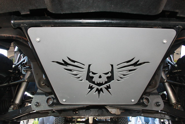

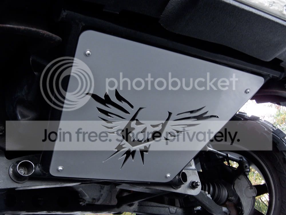

Trust me, you don't want to know what I went through today with this skidplate, I'm on my third one now, 3/16" hot rolled steel plate, the aluminum ones were garbage. This steel plate powdercoated like complete ass, need to spend a few hours trying to wet sand the clear.

The plate looks cool, but it's not the final one. I wanted soemthing that looked like polished aluminum. Because I was forced to use hot rolled steel plate )instead of cold rolled), it had millscale all over it and the pcoater couldn't get it all off well enough. So the chrome powder ended up looking more like silver. Actually the first coats looked better, we had to sand it down due to imperfections in the powder. Clearing it also took away some of the reflective properties. I may have to go with either s/s, or aircraft grade 1/4" aluminum which looks way better when pcoated.
