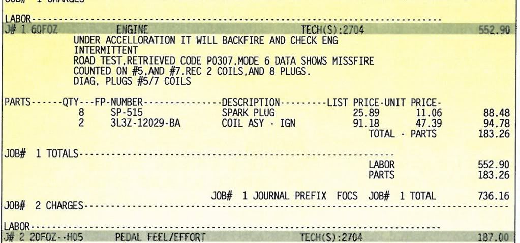

Mine finally gave up the ghost today. Backfiring, CEL, etc. They said it will need plugs.
It is at the dealer right now. :eek:
How many miles does it have?
91K
Okay, 3 plugs broke off, and it had 2 bad coil packs.
$744 !!
:eek:
That is ridonculous.
It runs. No significant gains in anything, but the CEL is off.

Wow you got screwed. The COPs run like 60 bucks each from Rock Auto and takes literally 5 seconds to install. No reason you should have been charged 300 for that.
Trent
mmmm beer
Sep 30, 2010
936
Durham, NC
Ouchhhh. Parts are decent. Sad part is it probably took them 2 hours total to do it but they charged you what the book says. Ridiculous
