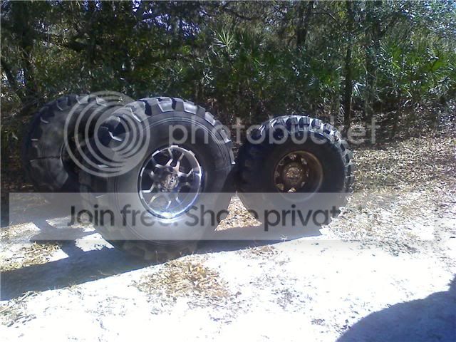

TIRES ARE ROUGHLY 49" Tall.
See the difference from a 44" Ground Hawg to 49" Michelin XL

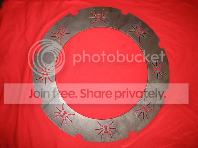

I wish I had a picture of how I want to bing in alittle "spider" into it but I dont. So ill look for something. Its called a ROCK RING, they weld to the very lip of the wheel and stiffen the outside edge of the wheel. This can be in any design you want, well im thinking of doing mine in a spiderweb design. But this wont be happening on the current wheels. This will be going on the new set :wtf:

heres one set of wheel stiffeners that i really like
I will add I am in near 100% agreeement that those would be kick ass and add to the "Black Widow" concept and will like to see your topper/tonneau (it's only spelled right because I had to look it up :lol:) idea and the whole concept as it pulls together.:thumbs:
