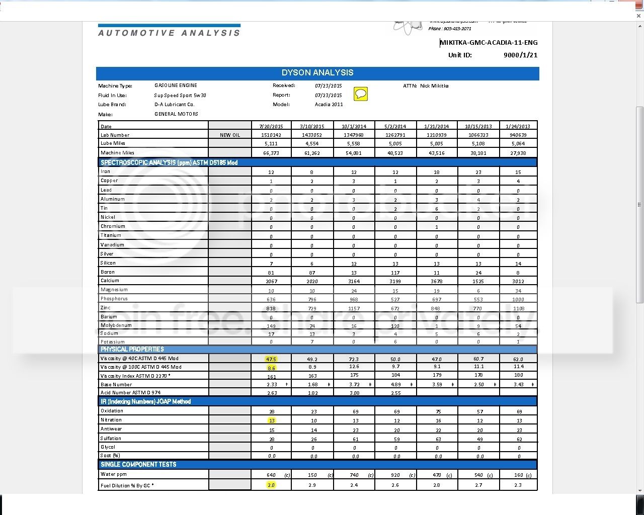

Here is what Terry wrote back and a picture of the report. My silicon finally came down, not sure why other than I must have gotten a better seal on the intake. The filters have been low mileage, I change them out at 10k to 15k miles. They report before this one is the AC Delco. The dealer that changed it only has it in bulk tanks, not in qts. Not sure if that makes a difference or not on the formula. The oil in the car before the AC Delco was the D-A Formula, they dumped it with only 2k miles on it, so it basically was a good flush/rinse oil for the most part. At least it wasn't expensive since I got the oil in exchange for a six pack of my home brew. :)
Nick, the D-A formula looks almost exactly like AC-DELCO Dexos formula. Very good result with lower fuels dilute than we have ever recorded with new lab but nitration and blow-by of fuels residuals sucks.
Summary :
1) low wear in spite of this engine shearing out this oil and all previous oils.
2) ring and power cylinder seal compromised but oil fought it.
3) nitration too high and IS building deposits because of it.
4) If you want low wear AND nitration in check RLI BIOSYN 5w30 Low Ash is where you need to head.
At YOUR service, Terry
