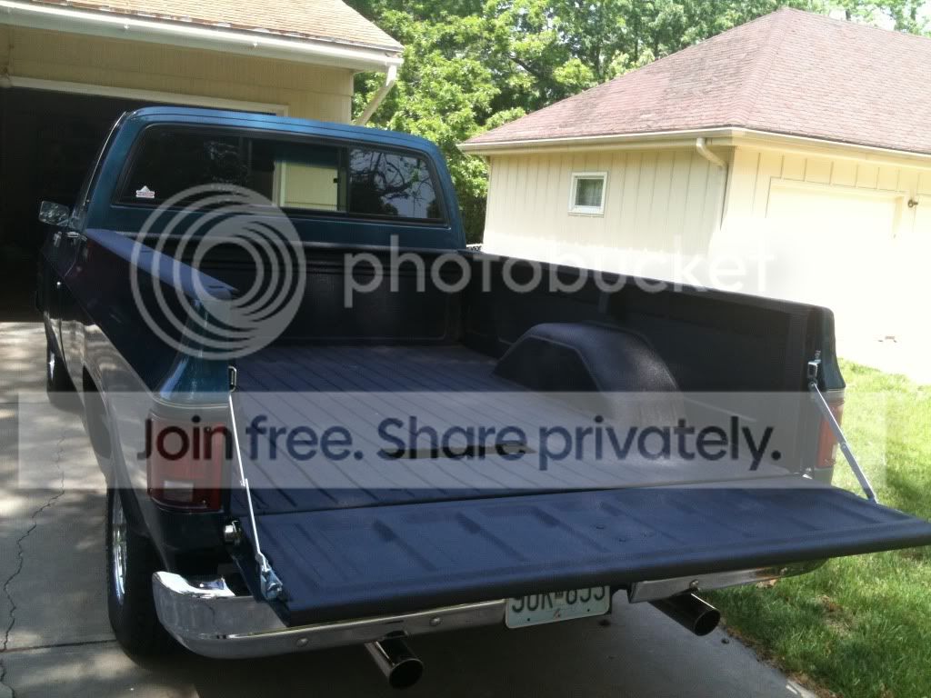

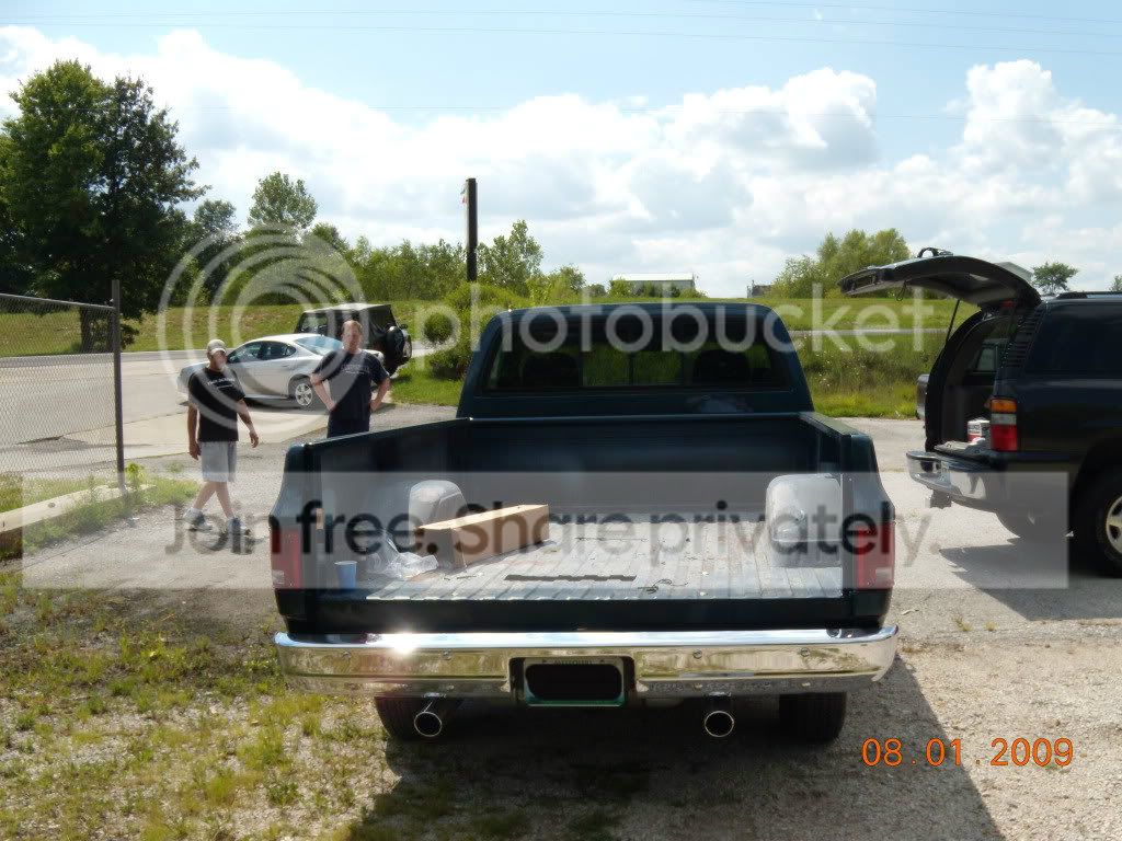

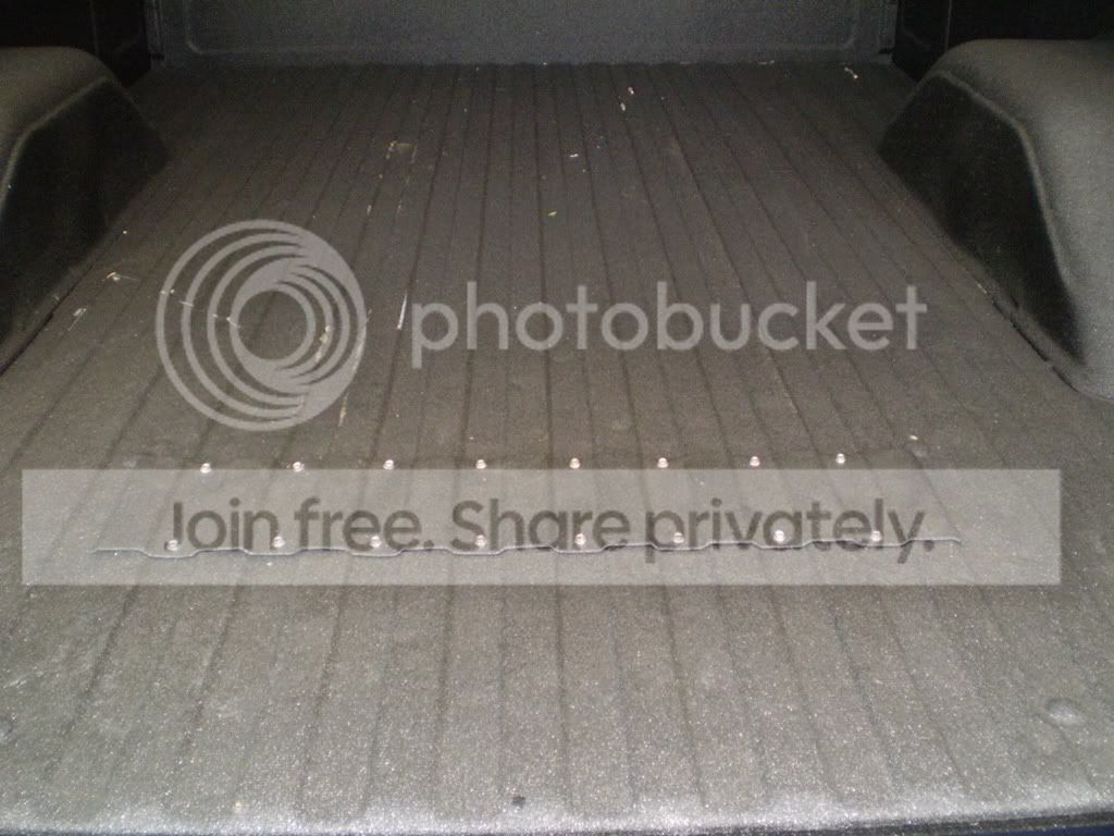

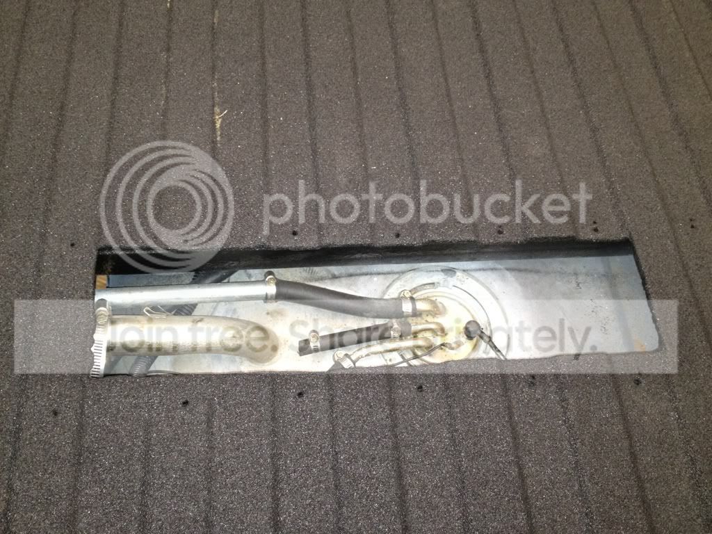

"Door" in the bed floor has been fastened in. I plan on using Plasti Dip on the screw heads so that they blend with the floor better. Just need to pick some up.
The purpose of this access panel is for ease of getting to the top of the fuel tank for the sending unit rather than having to drop the tank in case that ever needs repair for some reason.
