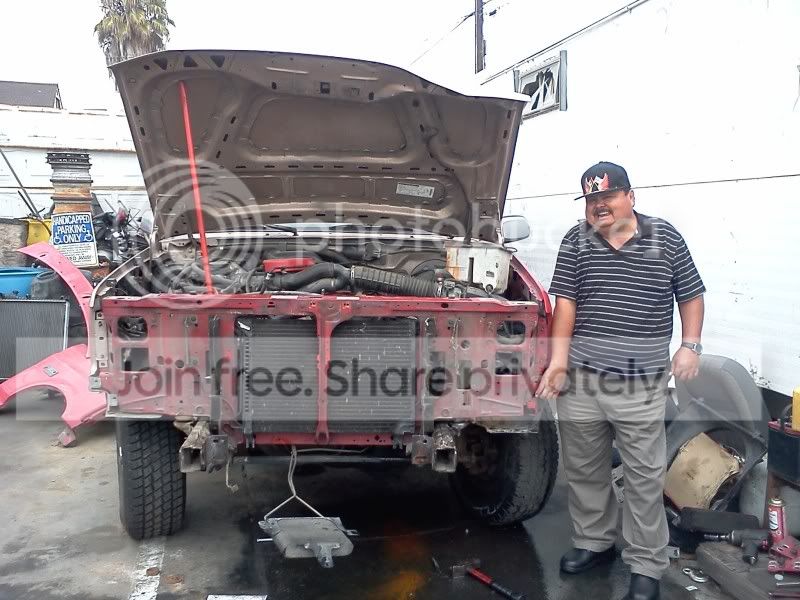

Looking at the damage after you removed the sheetmetal, I'd say you lucked out! It didn'[t do much structural damage at all. WOO HOO!
Hope you get it fixed soon Jose.

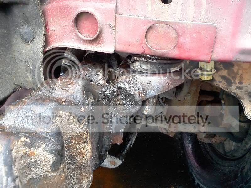

Aint that the truth! I was hoping I could have it all put together by this afternoon. Guess it'll be a few more days.
I'd take a torch to that bracket and bend it back into shape. You can always weld the part that split.
I'm gonna try, either way I have to use the torch to either bend it back or cut it off. Might as well give it a shot and save the $25 for the bracket. :thumbs:

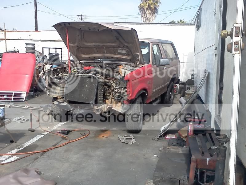

Got the fender off and test fitted the red one.
New core support torn down so I can wash it and paint it. I'll wash and paint the fender after we weld it.

Straightened out the mount today and test fitted the core support and the fender. My dad did the welding and he's hasn't used a mig welder before so please be nice. :lol:
That'll work fine. All it does is locate that front corner. Git er done!
