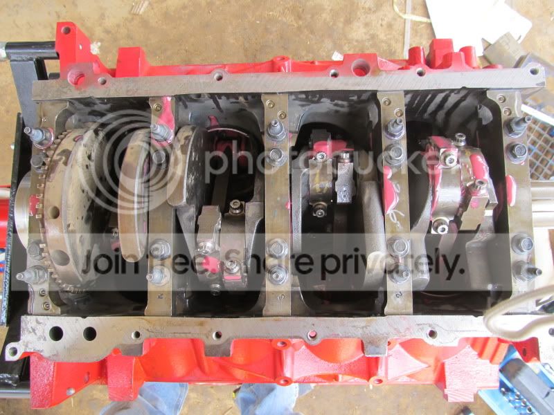

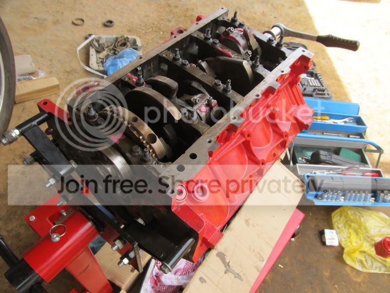

btw rotating assembly is in ,pistons, rods ,crank spin smoothly , cam is also in, oil pump is in
will torque the connecting rod bolts tomorow, install lifters ,heads,oil pan , and take some pics ,
hopefully, well tray to drop the motor tomorow and turn the engine
wish me luck:thumbs:

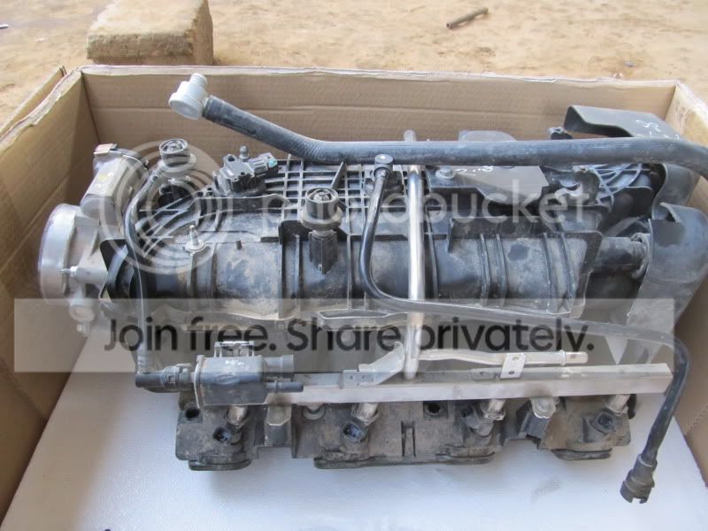

after we mounted the motor under the hood , and I was cleaning the intake manifold has a hole 2"x3"
you can see it just behind the throttle on the drivers side
