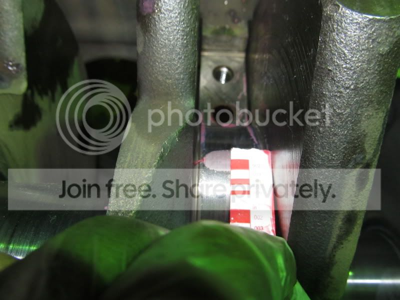

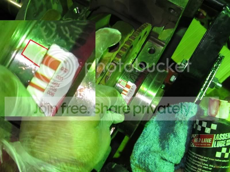

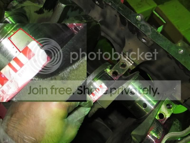

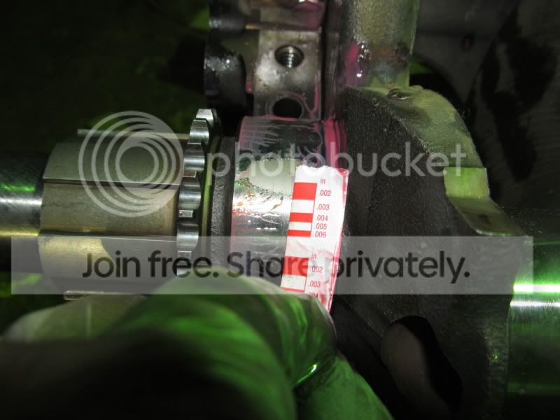

ok so i measured the crank main bearings oil clearence
here are some pics:
#5:0.0010-0.00009
#4:didnt mesure
#3:0.00007-0.00008
#2:0.0001-0.00009
#1:0.00007-0.00008
#5
#3
#2
#1
is that with in the spec?
