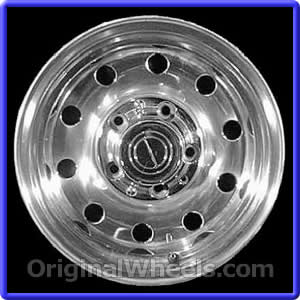

Looking to find a set of these with some street tires

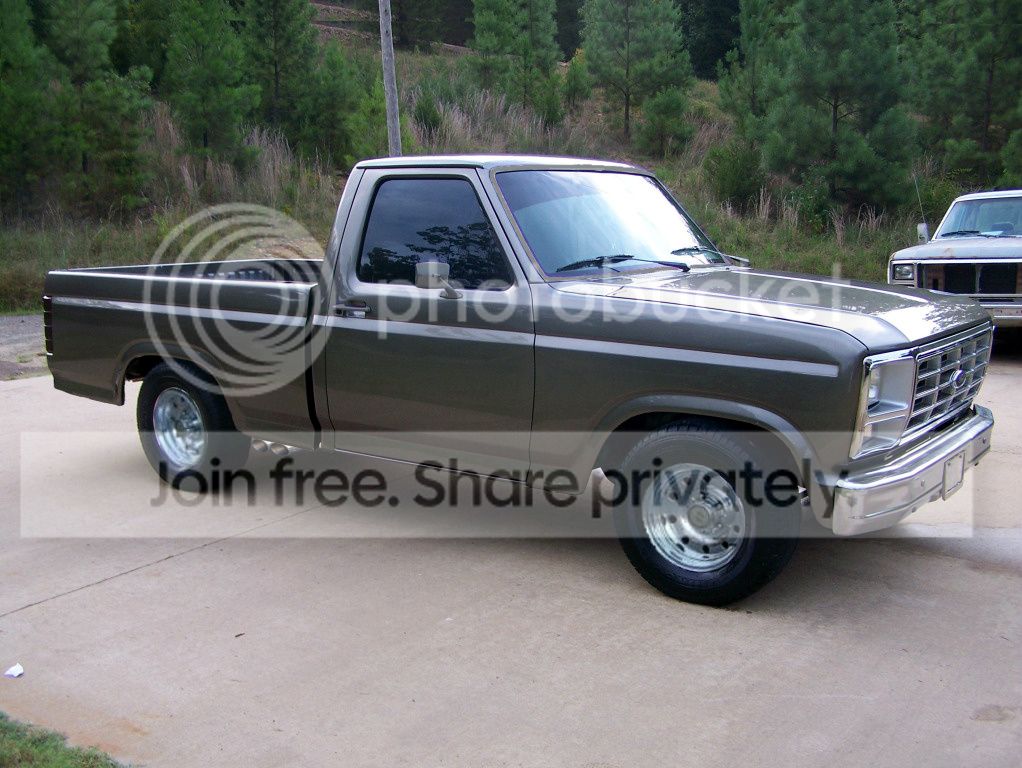

Did a quick chop of the xlt wheels. what do you guys think?
I love the look. Iffy about the exhaust tips though. Could someone PS the front end grey to match the truck?
