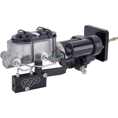

The frame that the Binder is sitting on is a 75 GMC K15, came with vacuum brakes ..
I found a 1999 C30 truck that has a hydroboost brake system, which is soon to be on the Binder ...
Looks fairly close to the above photo ...

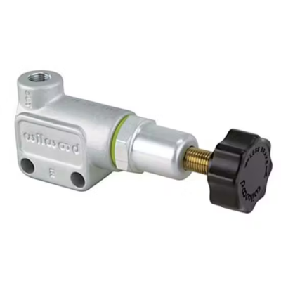

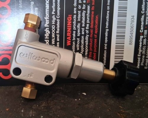

I'm installing a Wilwood valve on the rear brake line in order to balance the pressure ..
Reason for doing this swap is the new (To me) motor won't have enough vacuum at low rpms ...

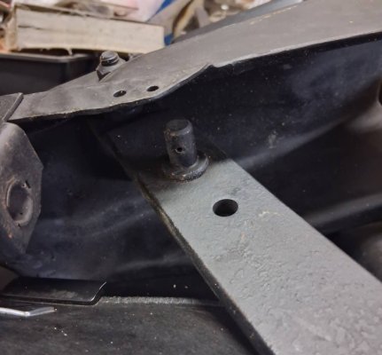

Got lucky with having the hole already drilled in the K15 pedal arm for the hydroboost ..
All I got to do is remove the pin and install it in the lower hole ..
The Wilwood valve just came in ..

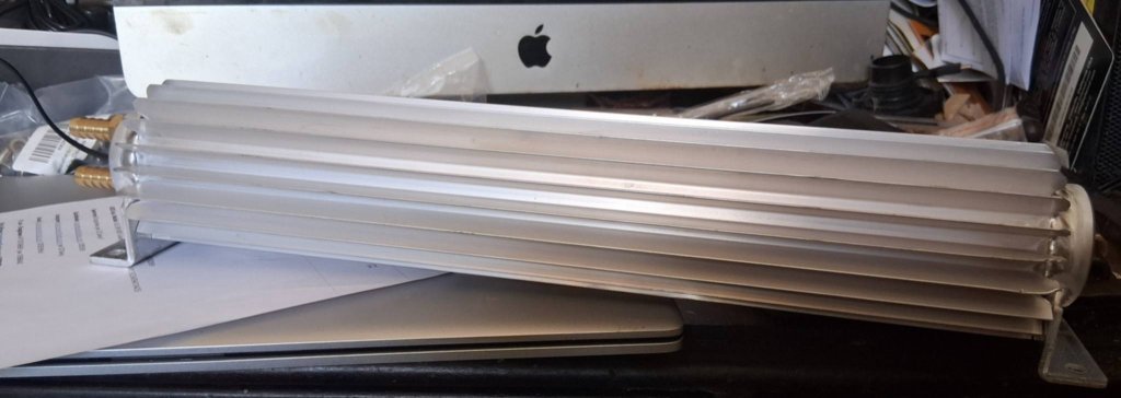

Also the power steering cooler ..
Not all that sure where I'm going to mount it ??
Most likely in the frame rail ..
