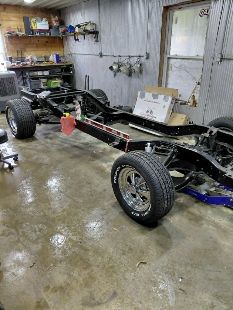

I'll do my best to update the progress on the 62 C-10 ..
He's moving right along with his truck build ..

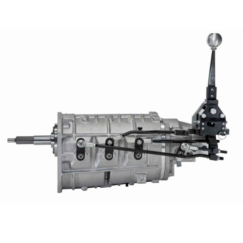

Still needs to nail down the 'Richmond Gear' remake of the M22 Rock Crusher trans, will be needing it to locate where the motor will be sitting ..
He's still in the think tank on the trans, might go with a 5-speed ??

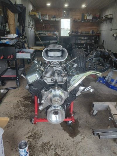

Once the engine gets to him, should see some fast action go down ...

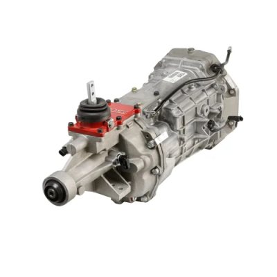

Or, being it's a truck, there is room for a 6 speed manual, with double OD VS the 5 speed with single OD. I have been looking at the TKX for my vette, but the kit is $5000, and that's not installed. There are a lot of choices on the TKX 5 speed, Tremec. Silver sport or American power sport transmissions both have a lot to choose from. The transmission alone is rite at $3000, for the TKX 5 speed. The 6 speed is more of corse.

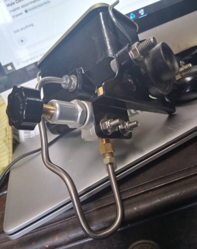

I'm installing a Wilwood valve on the rear brake line in order to balance the pressure ..

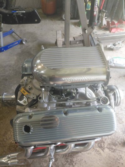

Reason for doing this swap is the new (To me) motor won't have enough vacuum at low rpms ...
Got lucky with having the hole already drilled in the K15 pedal arm for the hydroboost ..
All I got to do is remove the pin and install it in the lower hole ..
The Wilwood valve just came in ..
