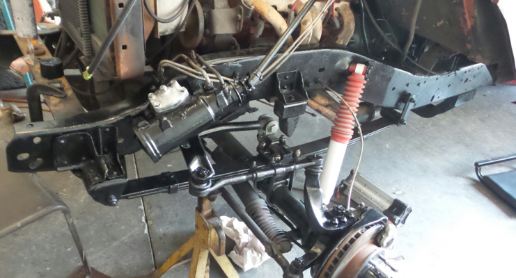

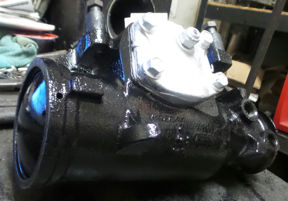

Still waiting for the U-Joint to get here ..
Will be able to get the steering box back on ..
Also need the brace .. Hurry-up and wait type thingie ..

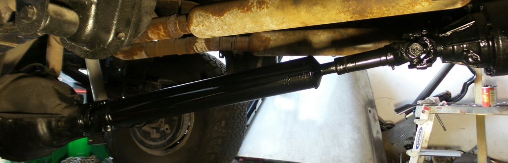

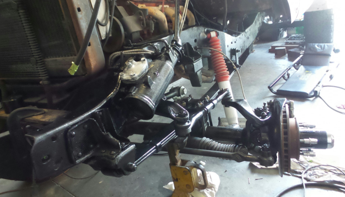

Got the driveshaft back, 3-1/2" shorter ..
The Boys did a superb job on it ...
Angle looks to be spot-on too ..
The two inch drop on the trans/transfer case netted the same angles at both joints..
Should be smooth sailing with no vibration ...

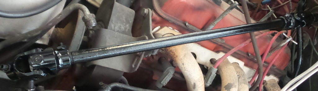

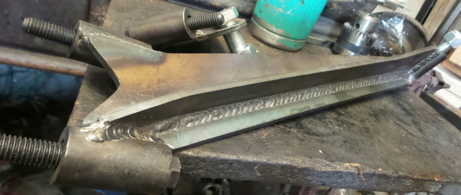

Steering box U-Joint came in ..
Need the brace and it's ready for "Lock & Load" ..

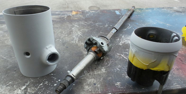

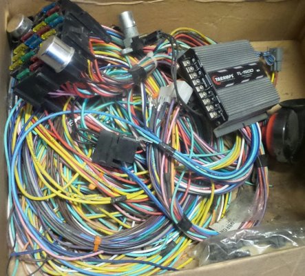

Found the internal shift stop ..
Do think I'll pull the column and get it on a workbench to modify the stop ...
I do have concerns about the factory switches having enough throw to allow for low gear engagement ??
I can use the "Ron Francis" indicator switch for the backup lights, it has the ability for them to work built in ..
Neutral safety switch is a whole difference story ??
Soon to see how that's going to work out ...
Cleaning up the parts as I'm going along ...
Jesse S
Mar 1, 2024
481
512
Belleview Florida US of A
Neutral safety switch ..
It's also built into the Dakota Digital GSS-3000 Universal Gear Shift Sender ...
Gear Shift Position Sending Unit for use with our 12 volt LED indicators.
Includes: Mounting Hardware to fit the GM 4L80 & 4L80E automatic transmission. Fully push button adjustable with no magnets to align! Built in Neutral Safety Switch and Back-up Light Circuit. Decoder can be mounted inside the vehicle for easy access.
That will make the installation a lot easier .. !!

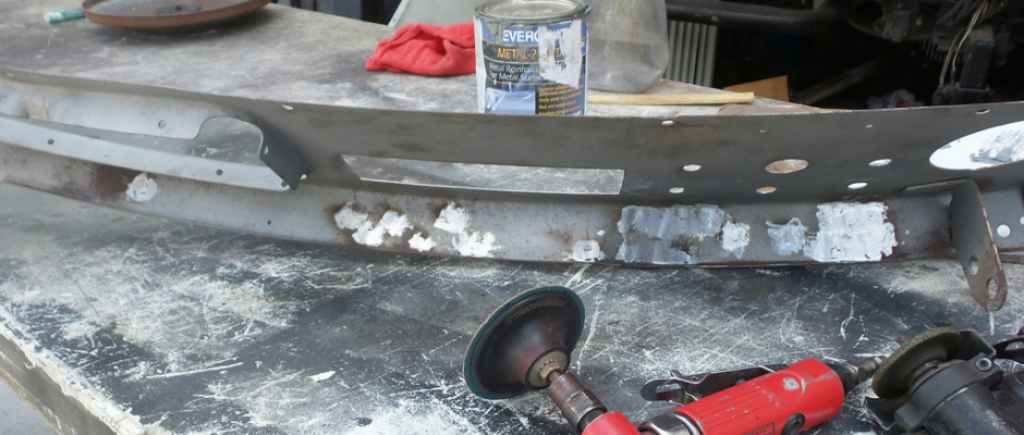

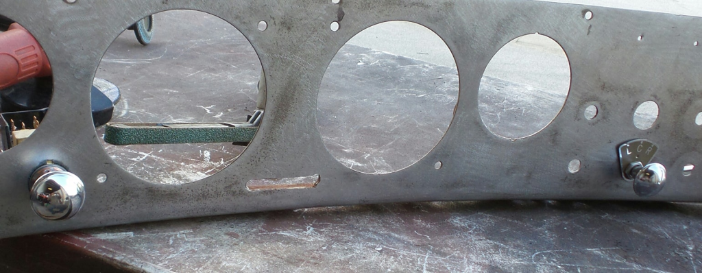

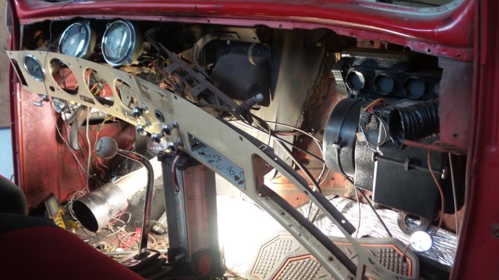

Well ...
Looks like it's that time ...
Eek !!
Holy Holes Batman ...
Got a few to fill with weld .. !!

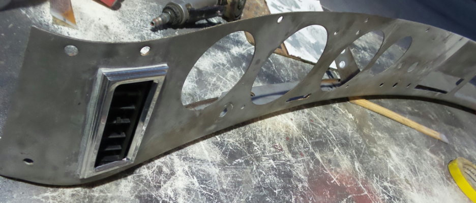

Headlight switch looks at home in the og starter switch hole ..
Moving right along with the project ..

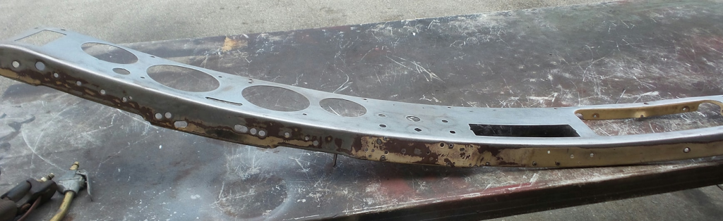

Filled the cracks around the AC vents will All-Metal ...
Once it's under paint it should look ok ??
Got most of the holes welded up ...
More to go ...
80,091
Are you painting that black? I think that it would look good. :dunno:
