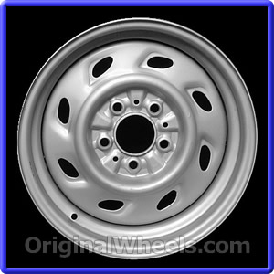

15in x 6, 5x 4 1/2, 12mm inset, f87a JA. Back inside of rim has this 13x6J TDOT Borlem 2079 II Brazil L685
Thats from a mid to late 90's Mazda truck , a B3000.
ok, it fits a Mazda B2500,B3000,B4000 93-on and MPV 99-on,

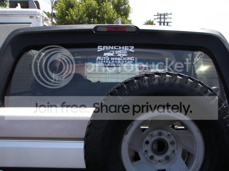

16x6.5 JT DOT USA, 6x5.00, tza b 23, k4 99, 021699 2 k4. AWTZA print on sticker inside the rim where the tire goes.

It should fit on all Ford Rangers too.
15in, 5 lug, 114.3/4.50in.
But the F150 has a 5 on 5.5 inch bolt battern.
