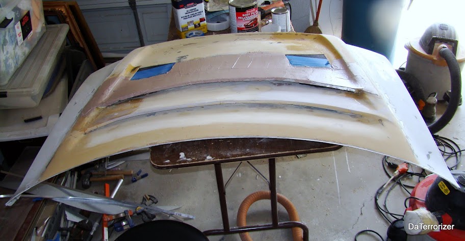

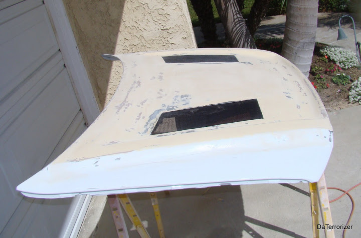

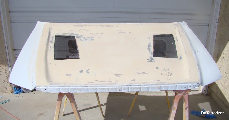

OK, got her all sanded down

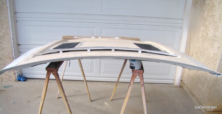

And my second rib/gill

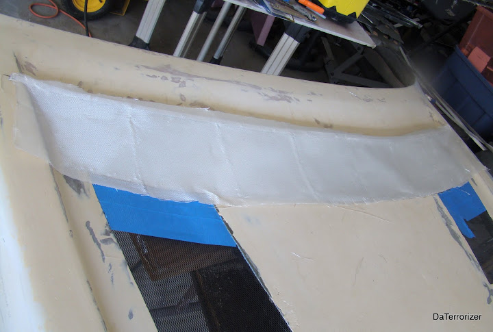

Made out of aluminum and galvanized metal sheeting.

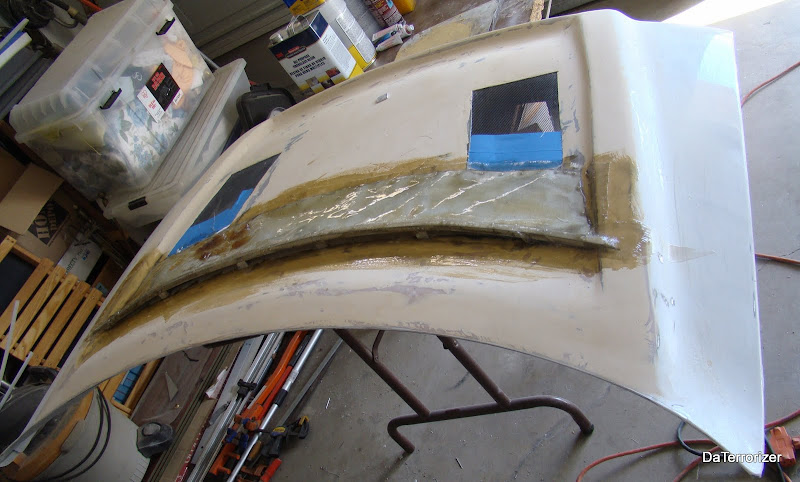

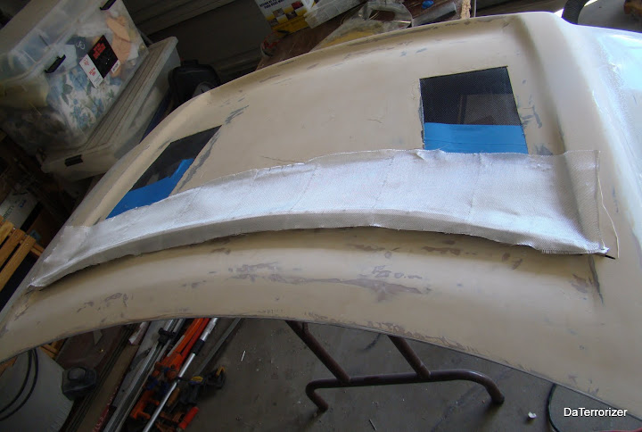

Then I added the fiber cloth
Then dded my liquid bondo and waiting for it to dry to add the top coating and even it out.

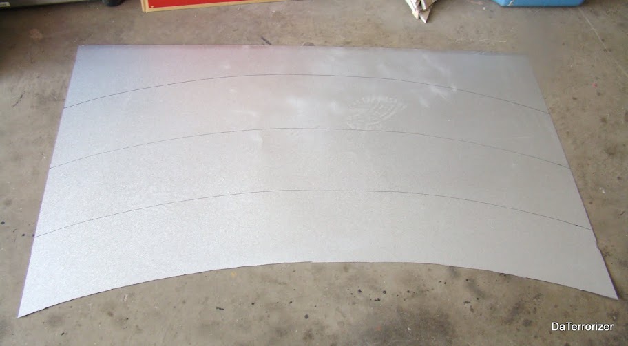

And got my other 3 pieces marked and ready to go.
O
OG-TERROR
Guest

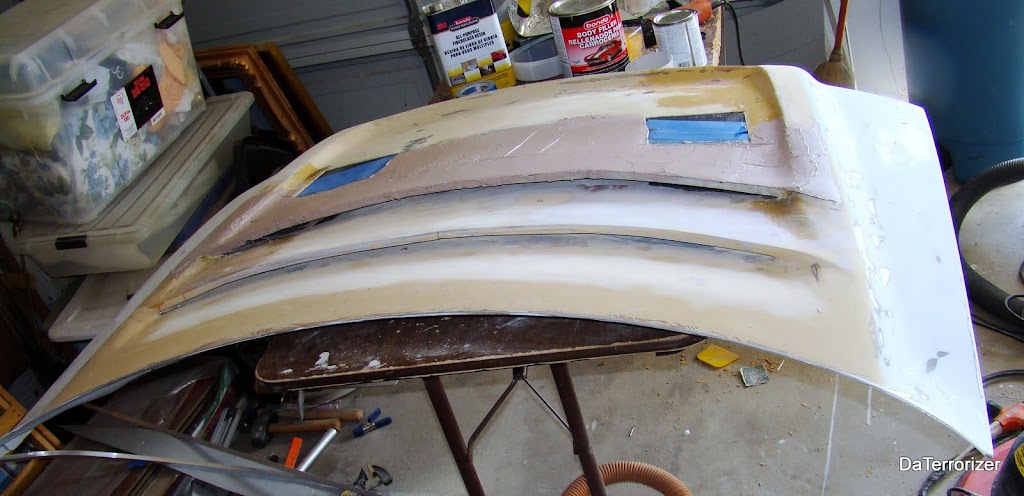

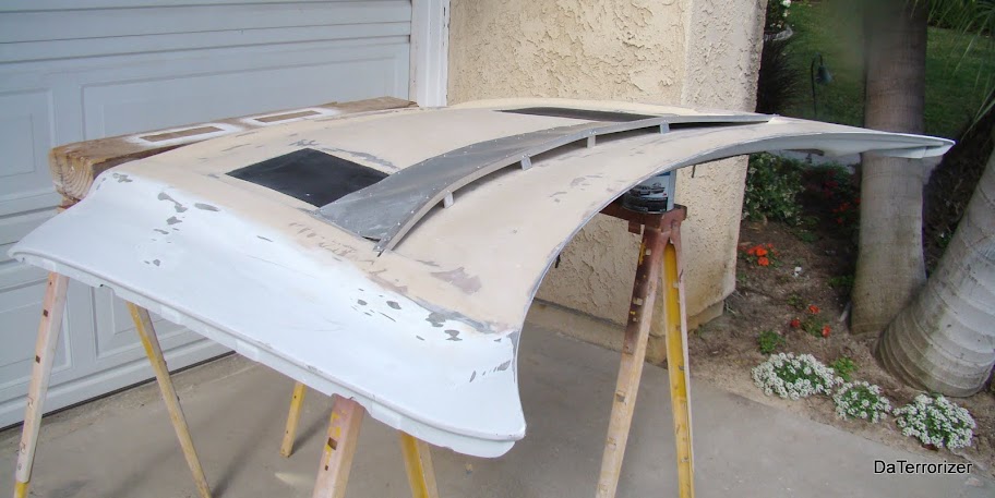

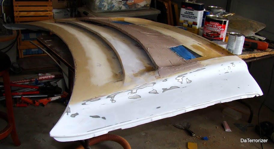

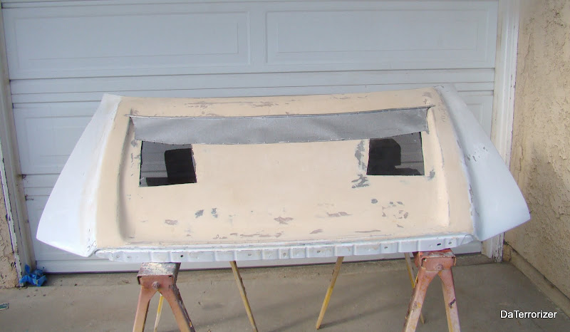

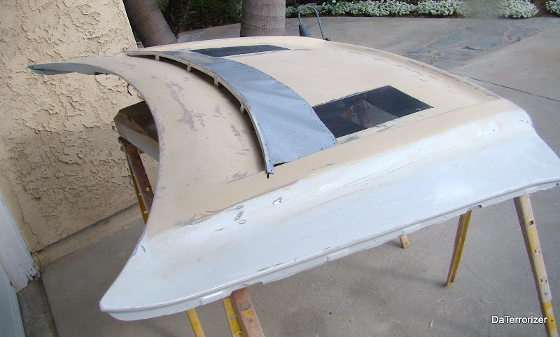

Okay ladies and gentlemen, I'm starting to feel much better as days go by. Las night I finished sanding my second rib :uhoh:.........well, the hood's rib..........
.....then added the third one. Just finished leveling it with filler bondo, now I'm waiting for it to dry so I can add the topping to smooth any imperfections.
On some of the pics it reflects uneven edges, not to worry, if you see them when the hood is completely finished then call me on it. For now if you have the need to call me on any imperfections you may see, please, raise you hand first, then place it over your mouth. :jester:
